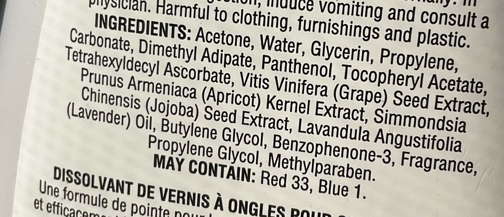

Turns out I don’t have pure acetone at the cabin, must be at home. I do have fingernail polish remover with acetone. See photo for ingredients. I do have paint thinner and varsol. Would they work?

I'd suggest not using the nail polish remover...water never helps with epoxies...out of your other two choices, I'd use the varsol unless you know what is in the paint thinner....

Anything that is a pure solvent should work, as long as it's not oily. I use Acetone and Lacquer thinner because it can soften the plastic and doesn't leave a residue that can prevent the Epoxy sticking.
