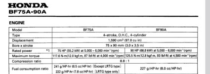

JGMO is spot on with the RPM (attached are some spec that may interest you)
