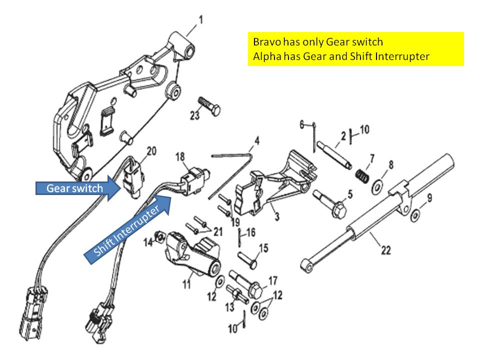

Fun Times can correct me but is there not an "in gear" switch or connector that prevents over revving in neutral that limits revs somewhere in the 3000 - 3500 rpm range? This may have gone bad and the ECM thinks it's in neutral. It can be disconnected with no impact on anything else. I disconnected mine just as a pre-emptive measeure. I have a 2002 5.0 MPI.
My boat is an hour and a half from me or I would send a pic. IIRC it was starboard side top of engine VERY near the shift interrupt connection. Seems like it was blue/purple connector maybe. Worth a try.

Plus a yes with Mark S. suggestion with the gear indicator switch could limit the RPM to right around 3600 if the ECM thinks it’s in neutral gear.
The following location of that item image is also in thanks to member AllDodge for making up each location mounted on the shift plate,
Bingo.....wow thanks very much that was it. I unplugged the gear switch and everything working perfectly now. Im assuming no need to replace switch. Is its sole purpose to limit rpm in neutral?
That’s my understanding. It’s to stop idiots from over revving in neutral. Mine has been running perfect ever since unplugging it so apparently it doesn’t affect anything else.
With the gear indicator switch unplugged defaults to the ECM that you're in gear when it's not really...Should you consider putting a new one in if the old switch is ever found not to be out of an adjustment, then check out item number 20, merc part number 87-808009T11...
