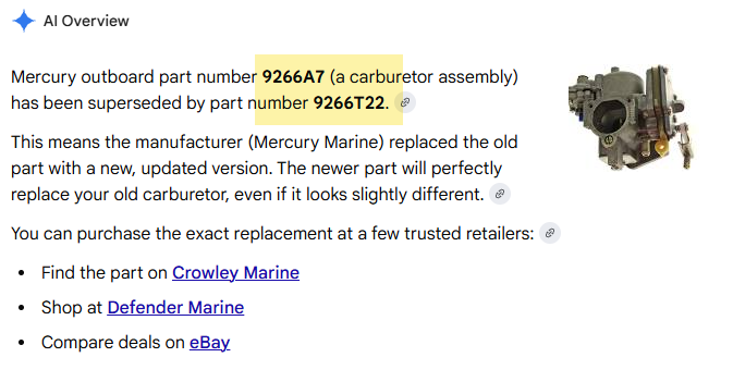

It looks like the fuel pump plate is not available .I am even having a hard time finding an aftermarket carb for this . an oem is about 6 or 7 hundred.
this looks identical
to my carb
Thanks in advance for any help/advice
I'm with you on google AI (grain of salt)
Thanks for the ebay link. It looks like that's a match. It is ready to rebuild with no gaskets.
It would be about 250 to get here where i am. I guess i could hope my fuel pump plate is bad and this used one would fix it.
Original would be about 650 before shipping.
Runners of the same age are going for about 600 to 800 up here .I might be best to go that route and use this one for parts.
I guess its decision time.
