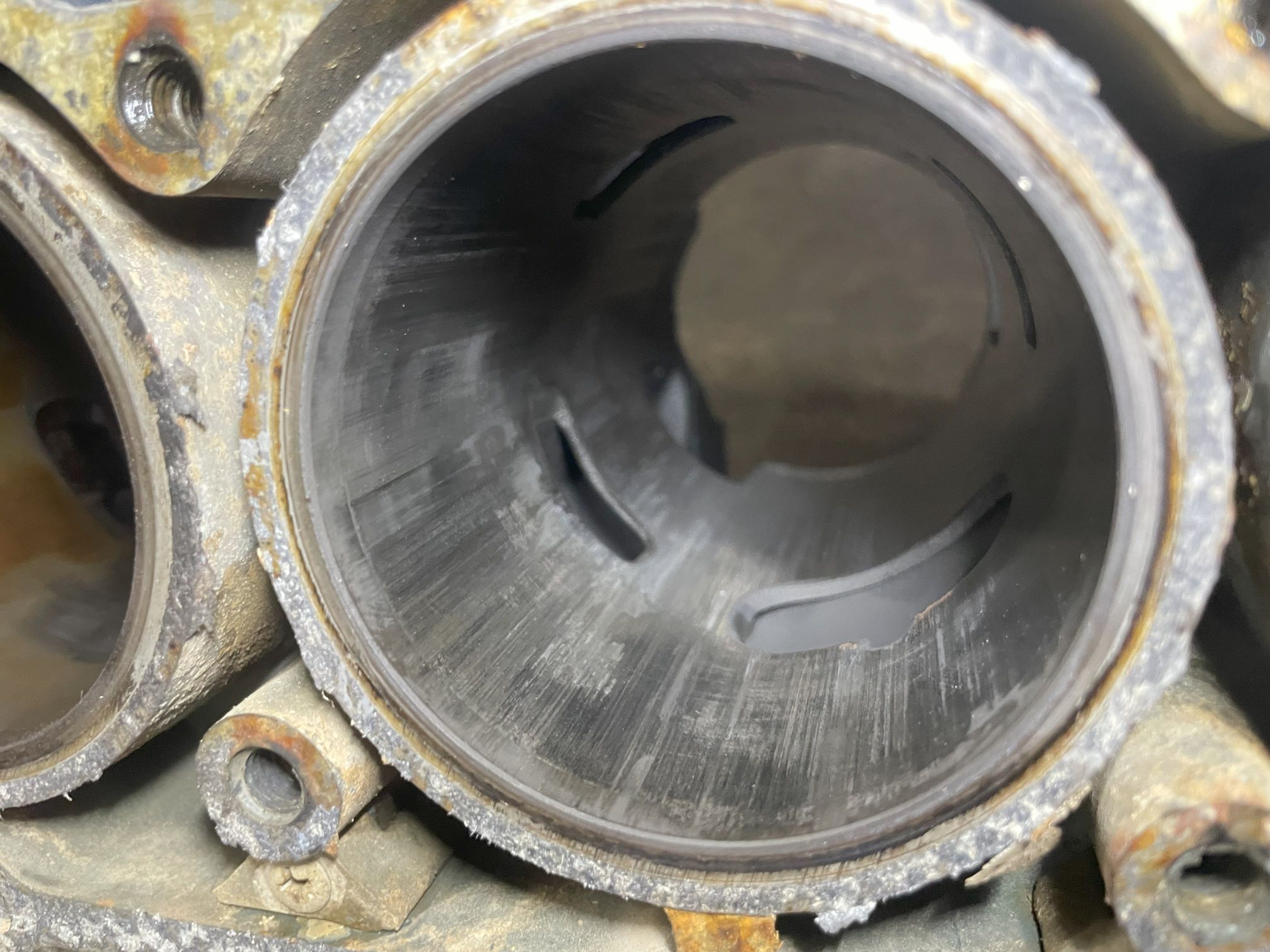

I took the motor apart today. I am including some pics. #2 is the bad one and #3 had scoring as well. Crank bearings feel good. There was Carbon on the top one which cleaned up easily. Big end bearings are free, but the small end rod bearings are bad on the #2 piston. Head looked good and seals didnt seem damaged. There is a piece missing, I think, in the casting on the oil injection after the carb but this did not cause the failure.
So, looks like it got hot and then aluminum transferred to the cylinder. I do plan on putting in a new impeller, but the old one is good and it always had a good pee stream. I had not replaced the thermostat and it was original.
Nothing has been touched on this motor. I had to crack open all the paint covering all the surfaces.
IS there anything I should be looking for that I would not think about if it were a chainsaw engine? I am used to working extensively on those of that era. I think I could go up to .030 over but would try for less. Next step is to find a machine shop unless I am missing something.

I dropped it off at the machine shop. I also noticed the brass oiler gear in the crankcase was almost wore through. Since #2 melted all the way around the cylinder, now, I am guessing it was not enough oil?
