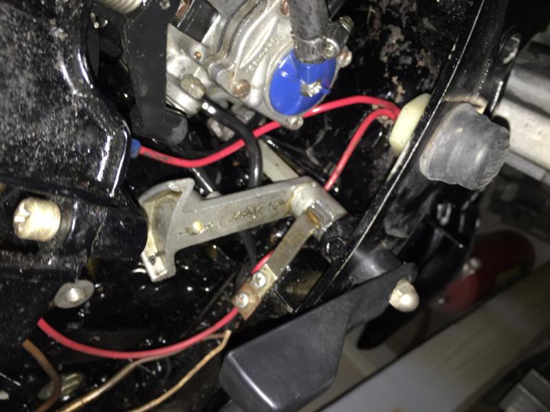

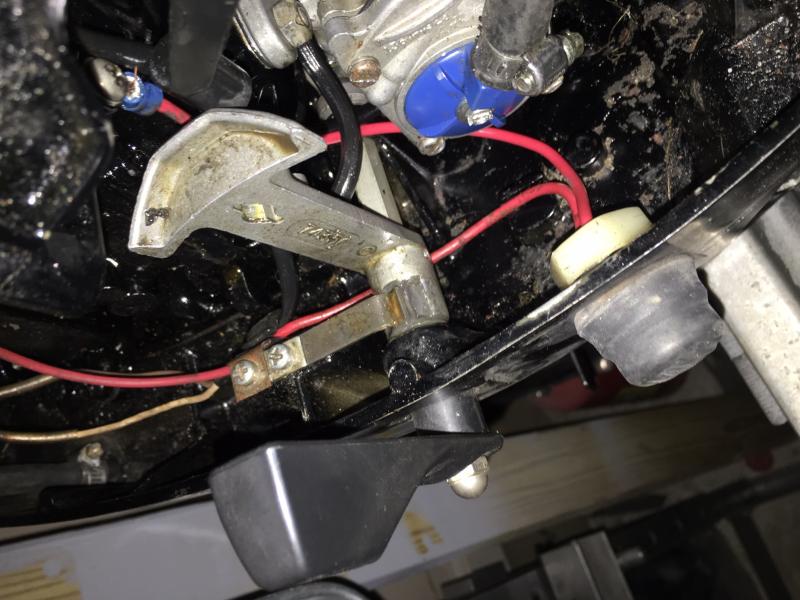

I removed the foot off a 9.8 merc to install an impeller. When I assembled I had forward and neutral - but no reverse. Every thread I read said I must have installed wrong. So tried a few more times with same results. So now I have the foot off and still not getting the "throw" I need from the shift lever. I will try to attached some pictures. IN: Forward the selector clicked into a detent under the cowl. Neutral also clicks into a detent. Reverse does not move enough to hit the detent (Lower unit is removed from engine)
My thoughts are that maybe this engine has some sort of safety that will not allow reverse if it is not locked to the transom? does this motor have anything like that? Also the manual says the engine can be damaged it shifted into reverse when not running... but what will get damaged/ what should I look for?

Did it shift properly before you did the impeller ,yes or no ?------Motor should not be shifted to reverse when not running.----Shifting between forward and neutral is OK.----Prop must be turned when shifting to reverse on a stand.-----Look at the reverse lock mechanism as there may be issues there.
Thank you - I never tried before. new purchase - I started the engine in a bucket and did not get any water. So I shut down and replaced the impeller.
Can you give me some details on the reverse lock mechanism – how should it function?
How did the water pump impeller look? This motor has a locking mechanism that keeps the motor from kicking up when in reverse, then releases it to tilt up in neutral and forward. Check to make sure that nothing is obstructing that movement down by the transom bracket and trim adjustment pin. Could also be that there was a pre existing condition that you didn't know about. I work on lots of these and have several in my shop right now, so let me know if you need some photos, or even need parts. The rotation of the shifting shaft, of course, activates this lock mechanism. Parts are made of plastic here and if carelessly operated.....damage occurs.
The impeller only had 3 blades left - and they were in rough shape. I blew out all the junk and got a good strong stream from the engine.
Just to be clear the damage of shifting into reverse is to the lower unit? So with the lower unit removed I should be safe to investigate and mess with the reverse lock and shift into reverse on the stand? Thanks for your help.
Right. If it shifts good with lower unit off then you are off one tooth on the splines and lock is not causing the trouble. I could tell another way, but if you do it your way, you will have the answer too.

Ok – was able to investigate a little more tonight. 99% sure the problem is with the reverse lock cam. F/N/R do not give any vertical movement to the rod leading to the transom hooks. Just a slight side to side binding. When I shift to Forward I have to manually move the rod to release the engine and tilt. Can't see any obvious damage, but it might just be wore out. When I shift to Reverse, the cam rotates and seems to bind up and not allow full motion of the shift lever.
So... Can I bypass this and not have a reverse lock? Or what would be involved replacing?
You really need to keep that lock, especially if you backtroll while fishing. Determine which parts are bad and notify me, I will direct you to cheap used or you can just order new from this site.....marineengine parts. I have seen a lock release done with a wire or makeshift string/cord, but it will take a little creativity on your part. Make sure to have it in release mode when traveling in high speed forward....in case of rock strike or grounding. Maybe you don't care about backing up, but that lock is a must for fishing using a backtroll method.
The more I look at it - It appears to me that if it was removed and turned one spline over it would work correctly. When I place the engine in forward it rotates and I still have about of 1/2" of travel for the metal rod remaining. When I shift to reverse it bottoms out in the groove to soon. So I would think I need to center the piece to allow equal motion in each direction.
Do I need to remove the saddle to access this? From what i see it is 4 Snap rings to release the pins and I should be able to gain access. Is this correct?

There's an orphan spline in that shifter coupler that is supposed to prohibit the shifter coupling from going together all but one way. Unfortunately, most of the (female end) of the couplers were plastic, which allows one to force the coupling together improperly. When that happens, you not only don't achieve reverse, separating the gearbox often rips out the lower shift rod.

Which way are you turning the LU shifter? Also which way does the top half of the shifter turn as you go from F to R? (There was two versions of that shifting setup.)

look at the locking assembly between the transom brackets. That lock needs to hold the motor down in neutral and reverse. It should only release the motor in forward.
I often set the lock to release in neutral too....that's just me.....doing what I shouldn't do, but what works better for my guiding. That way it is already in neutral when I tilt down the motor and start it. I have maybe 15 of these little Mercs around, and as I sell them, most customers appreciate the modification.
