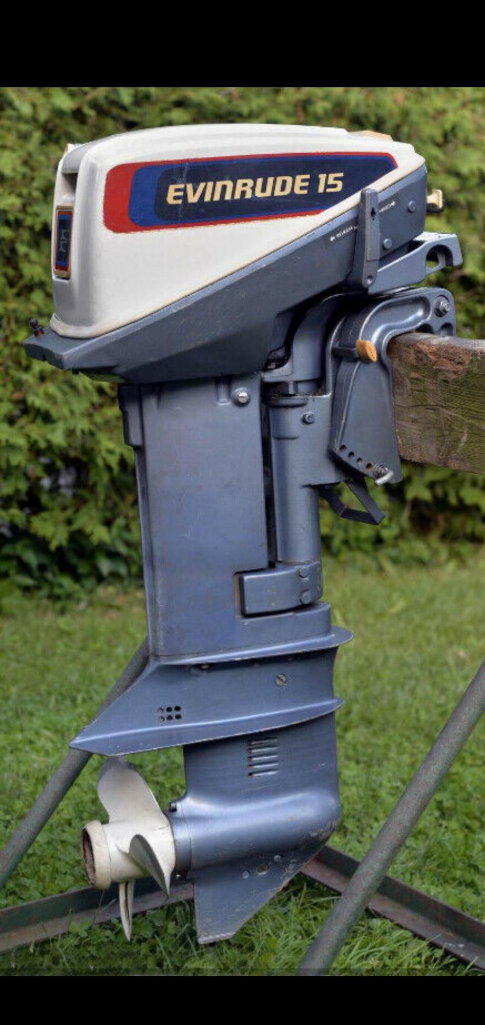

1976 Evinrude 15 HP
909
Just picked this up from a backyard mechanic.
Besides the carb, what else makes this different than a 9.9
How do I tune this engine for peak performance?
I thought the color scheme for 76' was gold. I guess the smaller engines were blue.
Graphics to seem to be 76'. My mistake.
Best advice I could give is get the factory manual.
That thing looks super clean, and 15s are hard to find where I live.

Johnsons were green/gold
