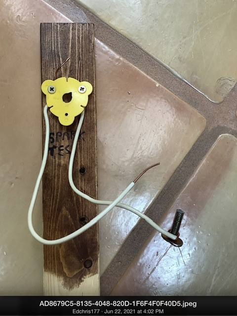

Build a cheap air gap tester, like this. For now, clean points & gap at .020. Replace flywheel & see if you have spark.
