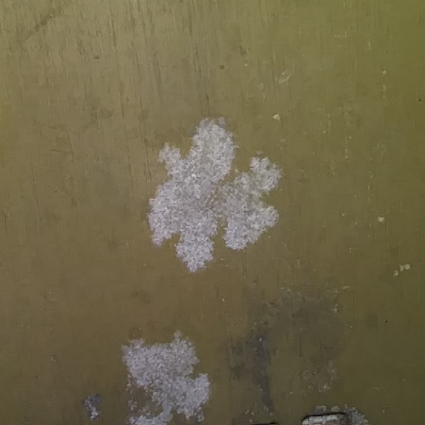

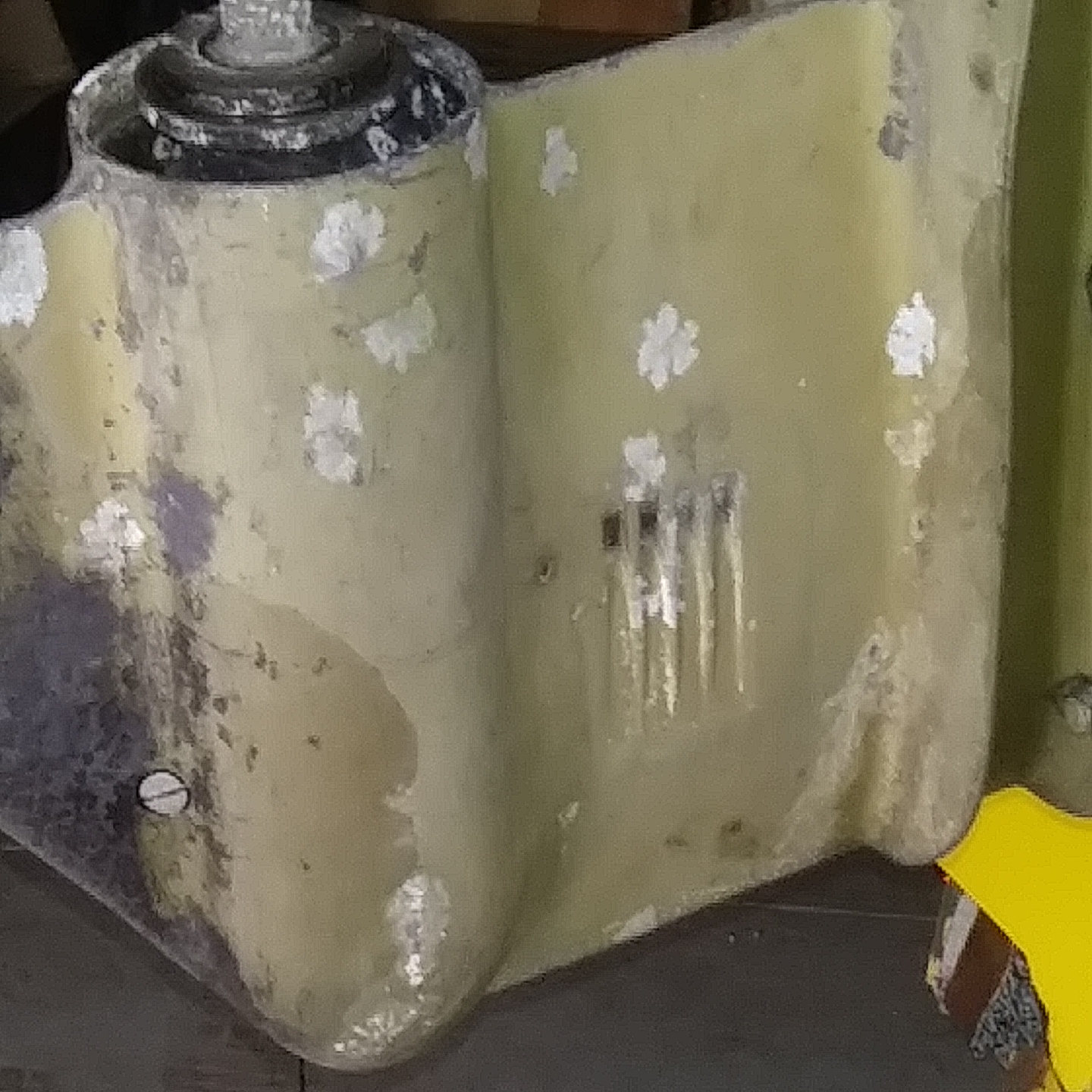

Does this motor have anodes?
I am going to deal with the corrosion and anodes came to mind.
If if does, where specifically are they?
Some pictures, I like pictures.
snowflakes
close-up snowflakes
close up snow flakes after light sanding with 220g20220330_111620[1].jpg20220330_111650[1].jpg20220330_113507[1].jpg
No anodes on it.----You might want to heck passageway from intake screen to the water pump.-----I think it needs attention.
