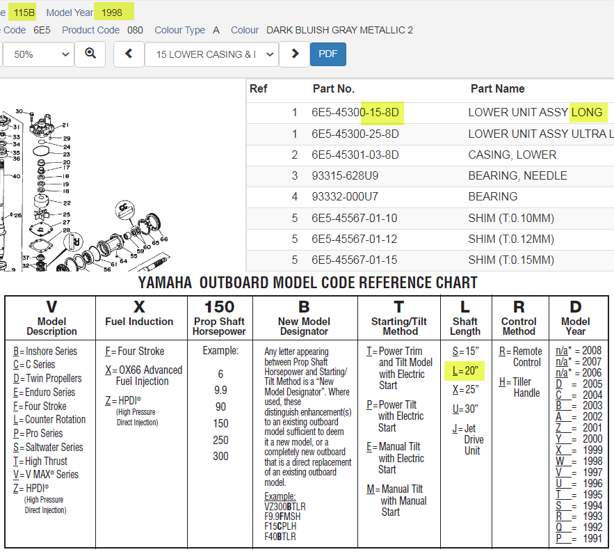

My motor is a 100TLR 2 strokes 1998 20 inch i am looking for a lower unit yamaha don't have it any more i want to know if the 115 TLR is OK to replace
boscoe
Advanced Contributor
The Yamaha Canada website shows parts catalogs for a 2000 model 100A and a 1998 model 115B.
The gear case housing is the same.
Would appear that the gear case from a 115 can be used on a 100. Presumption being the drive shafts are of the same length.
Tremray
Yes its
Part Number: 6E5-45300-15-8D
Part: LOWER UNIT ASSEMBLY
i am waiting to know if its is a 20 inches drive shaft ? (From Yamaha)
Tremray
There is
YAMAHA 6E5-45300-15-8D​
YAMAHA 6E5-45300-17-8D​
YAMAHA 6E5-45300-25-8D​
i am looking for 20 inches drive shaft ????
