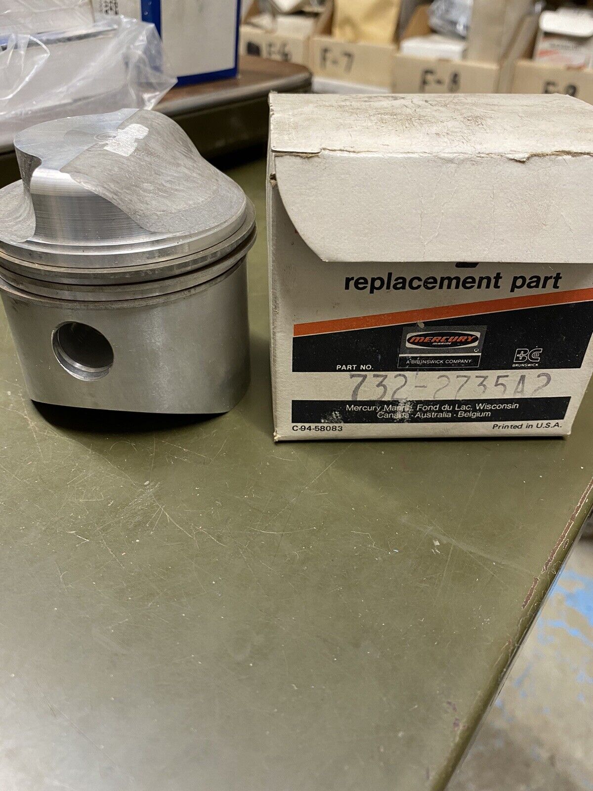

Thanks for the pic of the piston Faztbullet, I think that is what is in my Merc, 1986 model motor. I actually haven't still had the opportunity to take my boat out yet with to know what sort of fuel consumption is like since I bought it. I think it should be OK as it seems a big motor for the size of the boat. Glastron V156 with 75Hp, so will only need half throttle to get along at a good pace, I think???

I recall seeing pictures of what I said! That is why they called it "Direct" charging

Then why did I see a hole in the side of a Direct Charged Piston that cross flows don't have?

Yes the crown was still on the piston just like cross flow pistons. Unless you have all the exhaust tuning that comes with the looping process you need the crown to keep the bang in the cylinder long enough to get power out of the fuel mix.

My thought is the machined piston crown diverts the mixture instead directional ports. Is it possible that Mercury had a hybrid system, modified crossflow? Apparently my boat originally had an Evinrude 1969 model (not sure of the size) but the replacement 1986 75Hp Mercury was alot better fuel economy.
