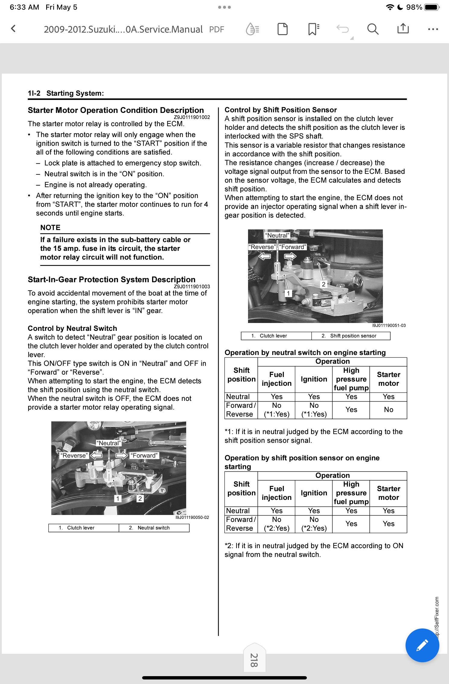

I replaced my throttle cables and now the engine won't start. Key will start power and beep but turning ignition does nothing. I checked a lot so far. Is it possible the neutral safety wasn't properly seated? Maybe the cables aren't aligned to actual neutral? Fuses seem ok after amp test. I checked cables, I'm about to check power to each wire and then disassemble the remote throttle again to check the neutral safety switch.
Anything else I'm missing? Some juju to reset the engine I'm not aware of? Thanks in advance for any help.
