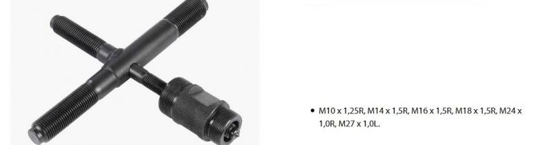

Im gonna pull the flywheel of my big twin. Havn´t been able to loosen the nut first gonna get an impact wrench for that. Once its gone and while anyone knows what threads I need for the flywheel removing tool? I planned on getting a custom tool anyone with experience think thats gonna work?
Or will a need the OMC special tool with 3 bolts to lock to the flywheel?
