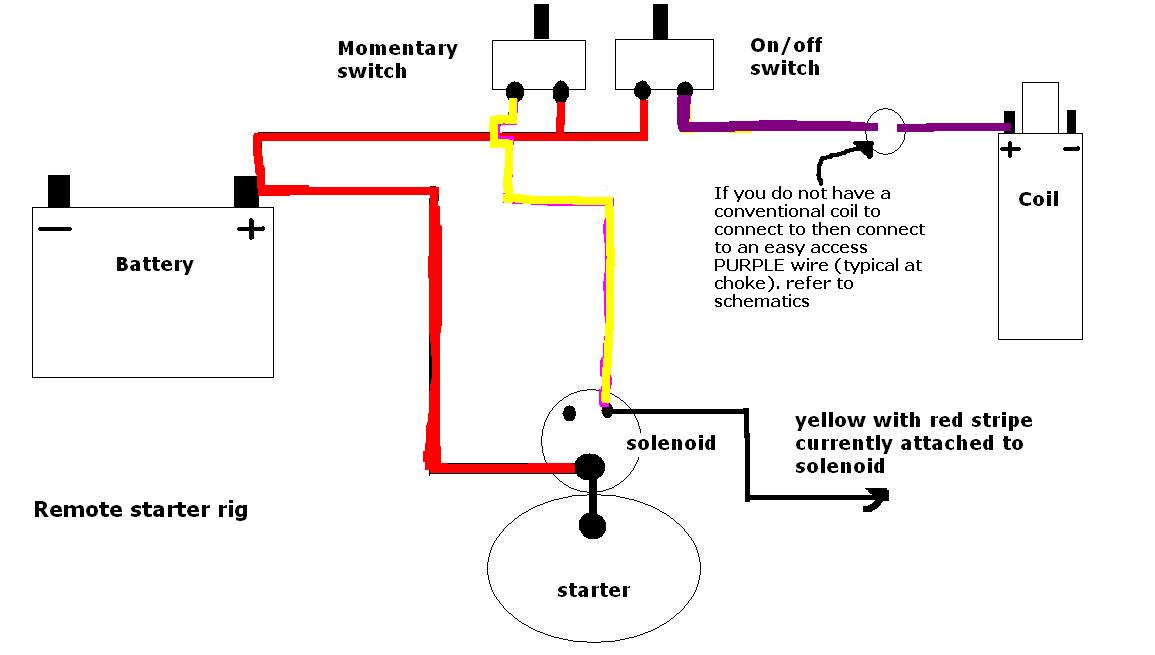

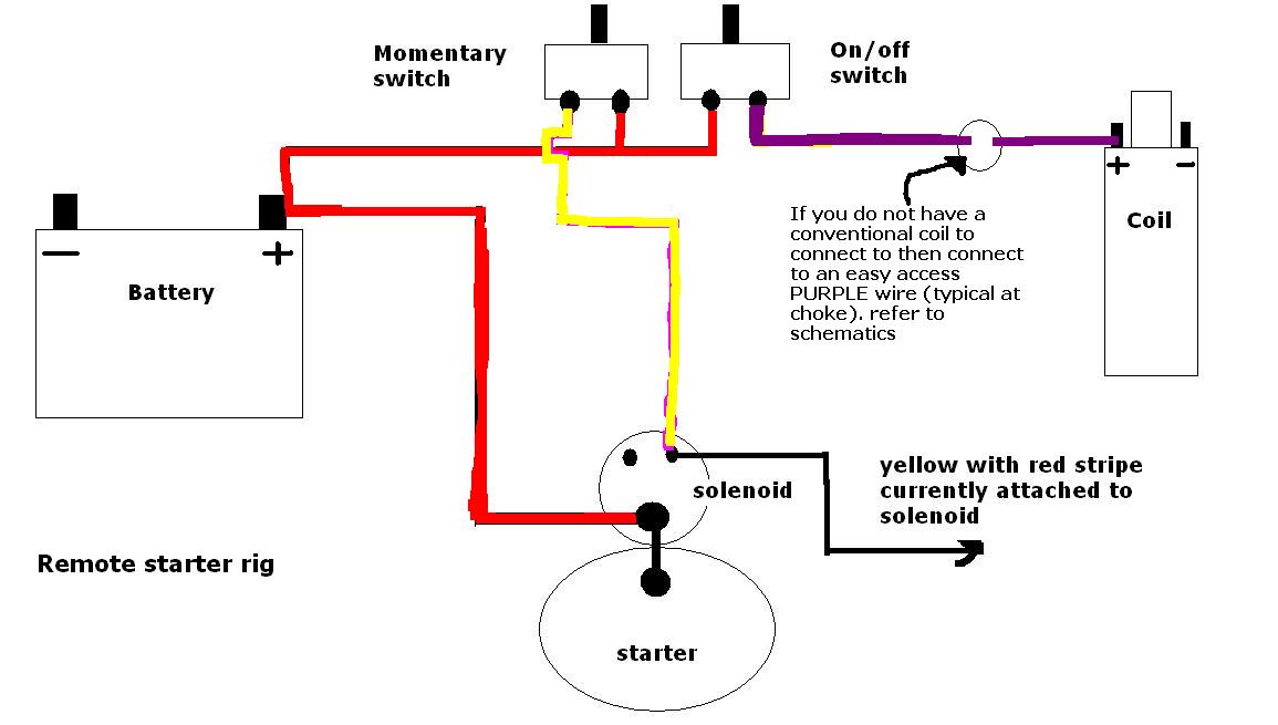

Make a jumper rig as my image describes. Connect as I describe directly to starter solenoid. Deal with slave solenoid after engine is reinstalled
Also you will need to jump out the oil pressure switch near oil filter. Remove both connections and jump them together. This will TEMPORARILY remove the oil pressure switch from power to fuel pump and allow pump to run when On/OFF switch is turned on. (NOTE: ON/OFF Switch must be turned off to shut fuel pump off for any reason) On/Off switch controls power to ignition. Momentary switch is used for cranking

In you diagram, the on/off and momentary switch are external devices, correct? I need to pick up a toggle and a push button to wiring up this rig?
Yes and no,
You dont need a push button switch but if you prefer that type then that works.
I use twp toggle type, one is on/off and one is momentary.
I have been using this test rig for many many years.
As an example,
You are trying to start and run your engine out of boat for first time.
Your method may have revealed a problem.
What do you do? You now have to trouble shoot your cranking problem before proceeding.
Using my suggested rig you can bupass (easily) the slave and connect directly to the starter bypassing the entire engine wire harness and focus starting and tuning your engine. Once complete you can then trouble shoot any cranking issues.
The need for the test rig is for trouble shooting electrical wire harness starting issues but also allows simple connecting to starter or slave and coil.
It allows easy control in your hands without jumping pins in a connector..
I did not do this for no reason and it has made controling the starting at the engine of the engine simple.
Oh, use alligator clips on the wire ends if you choose to make this test rig..
Personally I have never jumped pins in the connector in over 30 years...never even considered doing so.....i took the simple solution as for me itvis another tool to be used as needed.
