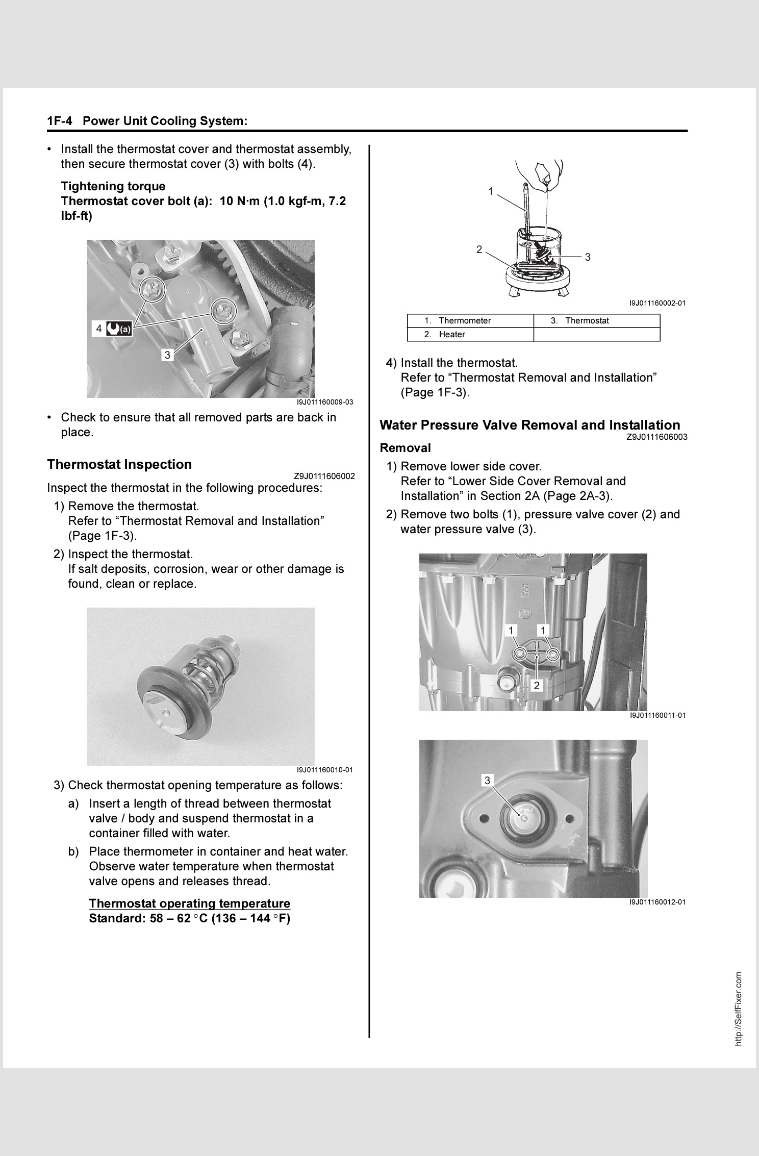

The pee sometimes spray big drops not a stream and sometimes 2 ft and sometimes 6 ft will run cool for a while then heat up I have replaced plate impeller , housing, thermostat,. I think there is a water pressure valve but so far haven't found location, appreciate some help. Thanks.
