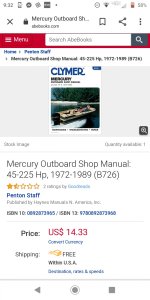

Relax, brother....life is full of idiots. They sell tools to just about anyone. If your on a budget.....this is the manual that can help you, not the best....but should cover enough to get your motor back together.
