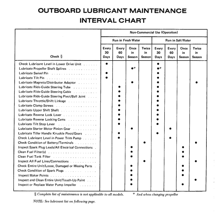

Here's a lubrication chart (not all points need attention) another unit that needs lubing is the control box seeing that it does a lot of work.
