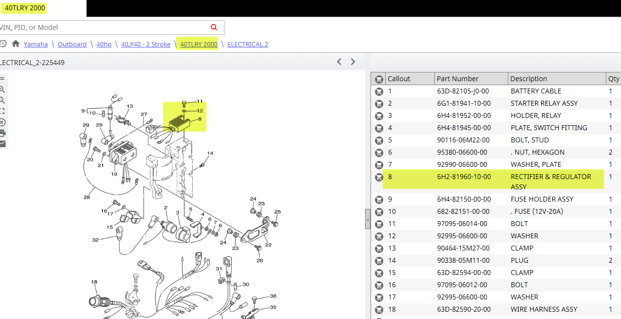

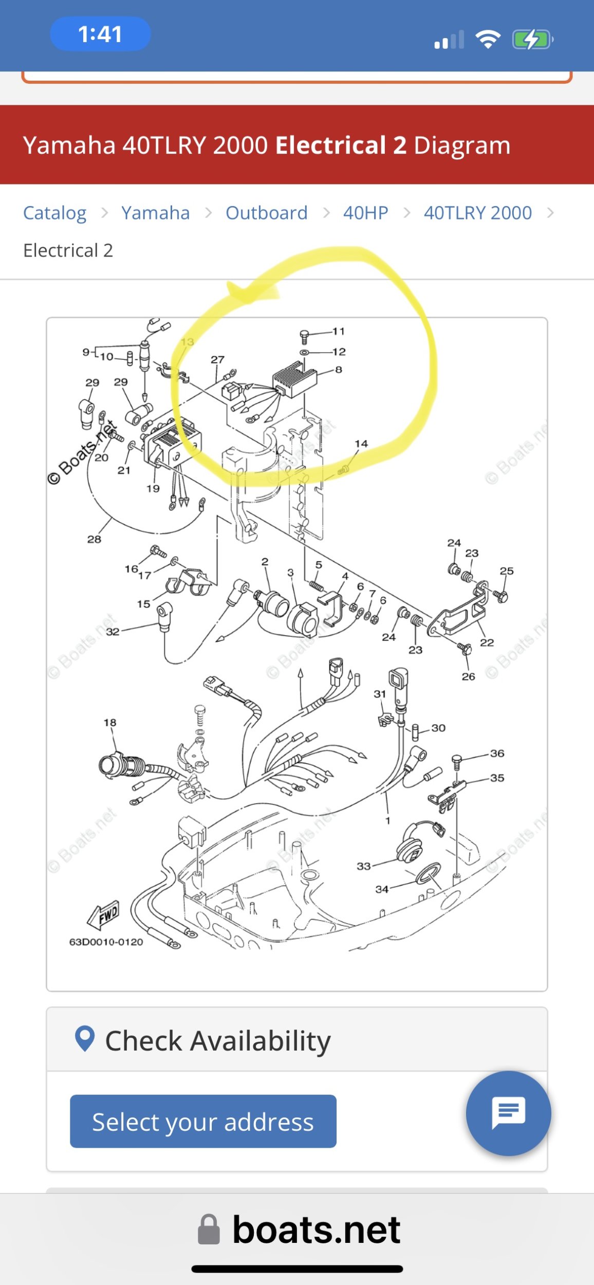

I’m dumbfounded. Need help, please. Where is the rectifier for my 2000 F40 TLRY? Nothing under the cowling resembles my new rectifier. I know I have the correct part. Thanks for the help.

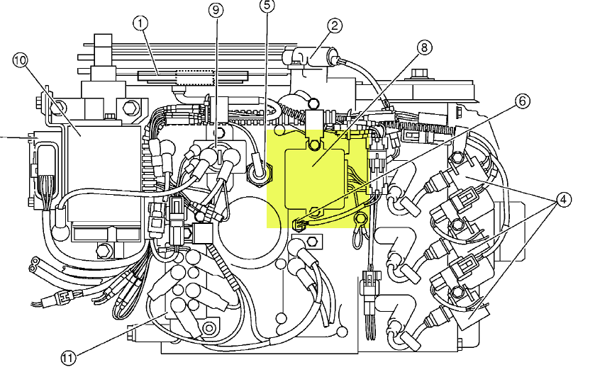

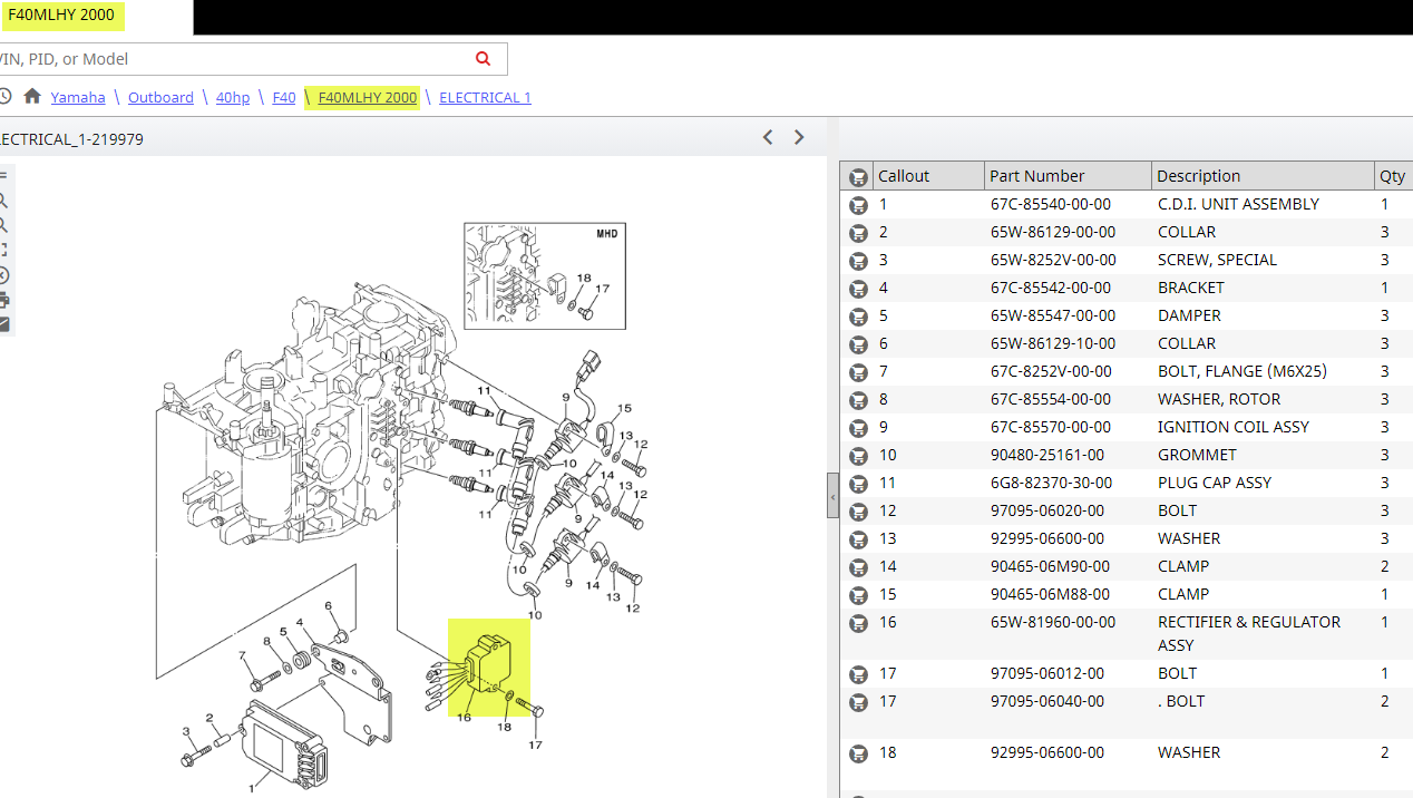

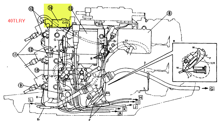

Appreciate that. The motor pictured is a different model. Mine is the F40TLRY. The layout on mine is totally different. The diagram I have of it is really not that clear where it is, other than toward the front and top area of the motor.
