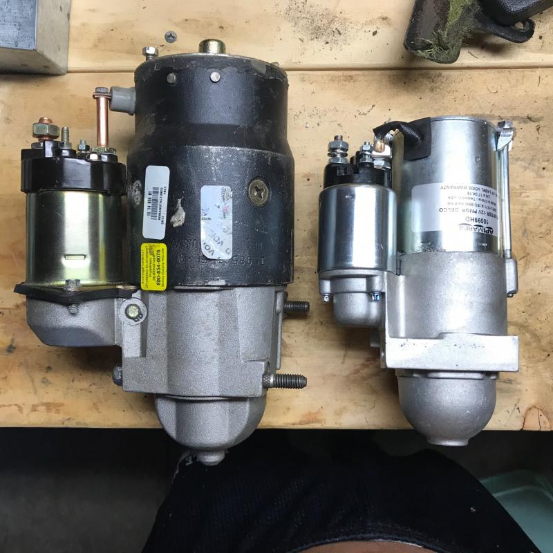

I recently purchased a 1987 Bayliner Trophy that had the engine replaced a few years ago - The first time out it ran like a dream and when I went back into the marina it stalled out and wouldn't turn over. The guy I bought the boat off of shared he had issues with starter in the past and had been replacing it about every two years. I spoke to him today and he shared that a mechanic friend took the marine parts off the previous starter and sealed it.
When I took the starter up to the marina the guy there sold me an API Marine 10099HD starter which is half the size of the starter that was in there. When we installed it, the starter didn't sound like it was lining up with the flywheel. I believe the guy at the marina sold me the incorrect starter, even though he swears that should work. The number I found on the block was (1023878), when I searched, it turned out to be an 1996-1997 OMC 305.
Any idea on what type of starter this engine takes?

that starter is a direct replacement, did the old starter just quit or was it making the same sound?
Thank you for the reply - I personally didn't have a chance to hear the engine turn over with the new starter because I was at work. My uncle said it sounded like the flywheel wasn't matching up with the gears in the starter.

Andy, with any SBC engine (car, truck or marine), the flywheel ring gear tooth count determines which starter motor is to used.
the 153 tooth will always use the starter motor with the straight across bolt pattern.
the 168 tooth will always use the starter motor with the staggered bolt pattern.
You will see the HTGR/PMGR starter motors as replacements. These are generally good. Especially the ones with all steel reduction gears!
You will also see the old school Non-Gear Reduction motors that by today's standards are pretty much out-dated and should NOT be used!
Do not let the pinion gear tooth count confuse you.
The flywheel ring gear tooth count is what you will be concerned with!
Make sure that you receive NEW bolts with the new starter motor!
(each brand HTGR/PMGR starter motors will have a unique nose housing casting)
Because of this, the mounting bolt length may become unique to this certain manufacturer.
In other words, use caution so that the specially knurled bolts will not bottom out prior to fully clamping the nose housing to the engine block.
Likewise, make sure that the bolts are long enough!

The OMC GM SBC Engine commonly used the 168 tooth ring gear flywheel. (early Volvo Penta used the 153 tooth)
If your old starter motor used the staggered Bolt Pattern, your new HTGR/PMGR starter motor will also use the staggered bolt pattern.
Some advertise 9 tooth pinion and/or 11 tooth pinion.
Don't be confused by this!
The nose housing and center of armature accounts for the differences.

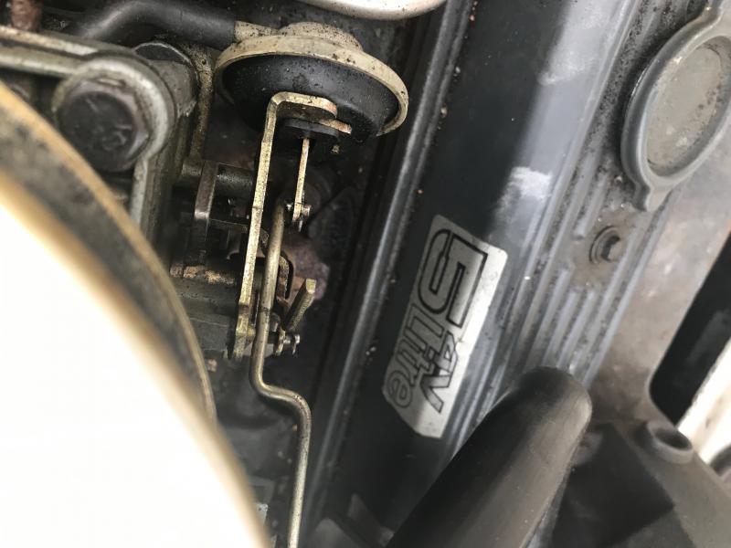

Ayuh,.... The usual culprits are the gaskets fail, 'tween the manifold, 'n riser,...
Or, after an overheat, the exhaust shutters are all burnt up, 'n allow back wash in,....
I agree with Bill.
With the engine warmed up, crack the bolts that secure the Elbow to the Manifold.
Finish the job when things cool back down.
Inside of this area will be the main exhaust gas chamber.
Around the perimeter of this area will be the "seawater transfer" ports.
The cast iron material must be in good condition, and the gasket must keep these two areas separated.
Post photos...... we can better help you if we can see how these areas look.
