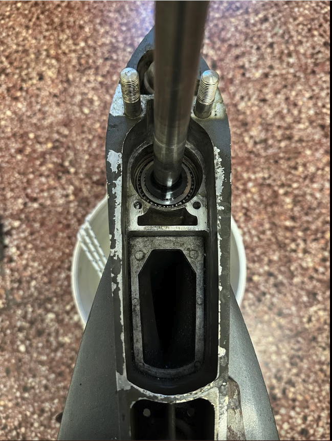

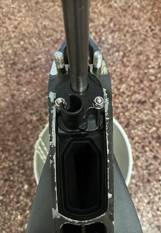

The procedure started with the disassembly of the upper housing, the impeller, gaskets, plates, etc. everything went really smoothly, until I tried to replace the lower housing.

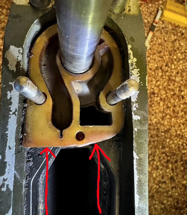

As it is the first time that I am trying to do the job, I went gently with a screwdriver, and tried to hand-force to move the part and try to separate it from the lower unit but with no luck.
Actual lower housing in the lower unit, and new one.
Red arrows are the places where I tried with the plane screwdriver.
So here is my dilema:
Keep the lower housing and just replace the upper, impeller, gasket and so on, or try to replace everything. I would prefer to replace all the parts (and gaskets below the lower housing), but I am worried about damaging some other part if I make force incorrectly, or maybe I am just not doing it correctly, so I would love some help on this matter.
