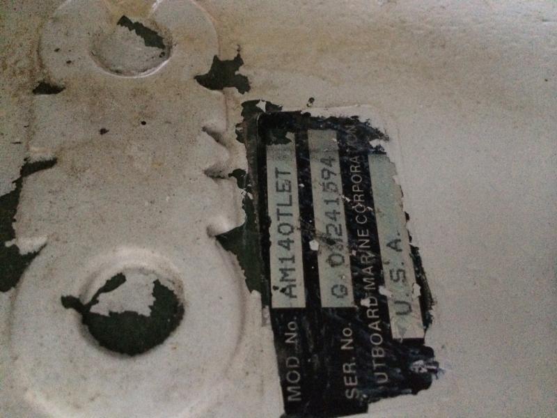

Hi
I have been investigating what I think is a fuel related issue causing a lack of power under load.
The bulb won't get hard and the engine runs rough under load but starts fine.
I have stripped the carbs for cleaning and was looking at removing and rebuilding the fuel pump.
I noticed a small cube shaped box with a small red hand handle under vro, can any one tell me what this is and what the red handle does?
Also what position the red handle has to be in?
