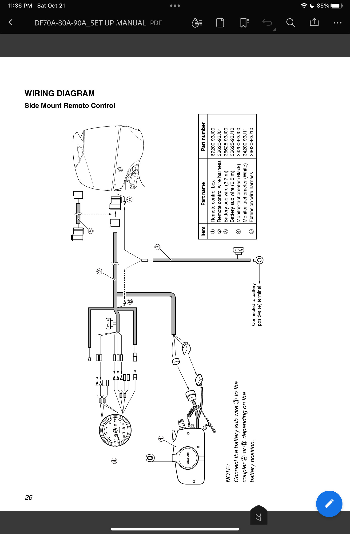

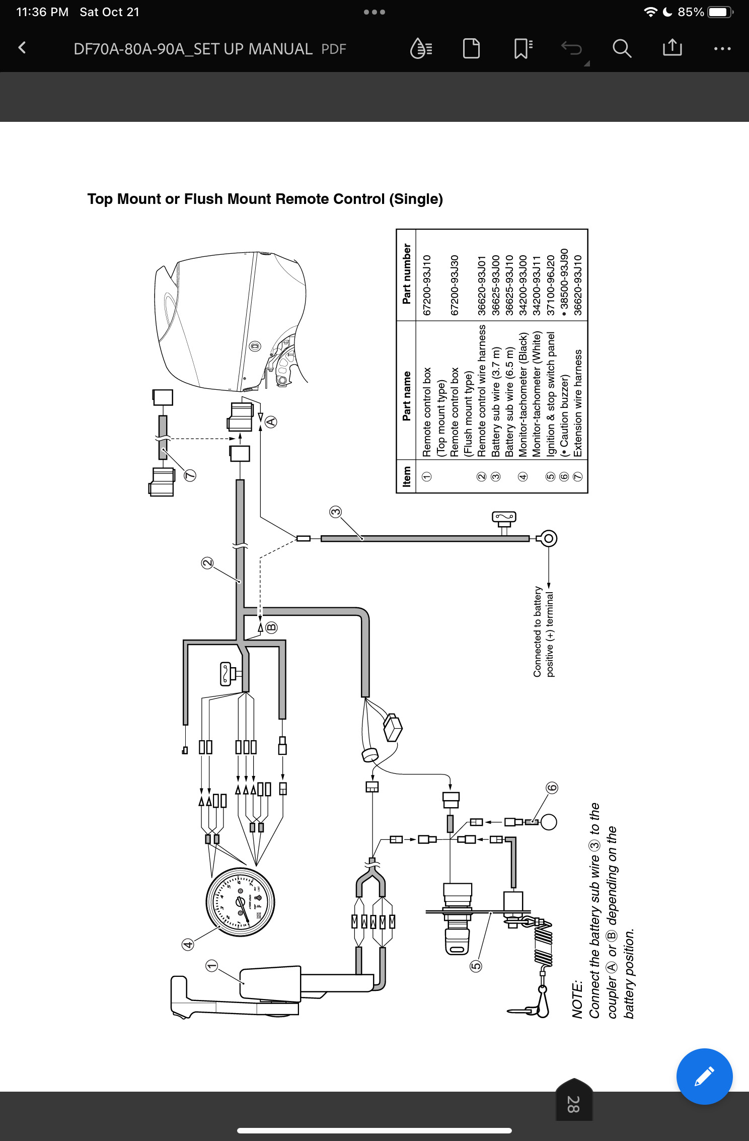

I purchased this engine 25001F-782099 with no controls. Attached are pictures of plugs on the wiring harness on the engine. I want to verify the part No. for the control box and tach I need with the engine. The plugs on the control box that was recommended to me do not appear to match the harness. Thanks in advance!
Well one plug is an 8 pin and the other is a square one that looks like a 4 pin. The control box recommended has an 8 pin and then a flat plug. The tach looks like it has a square connector. Is it possible that the 8 pin is all that's needed on the control box and the flat one isn't used. The square one for sure looks like it fits tach.
Digital or Analog? Side or top mount? If your engine age is close enough to 2009 I have some schematics that I could screenshot. Not sure if they will help. I think the flat plug MIGHT be for trim.
