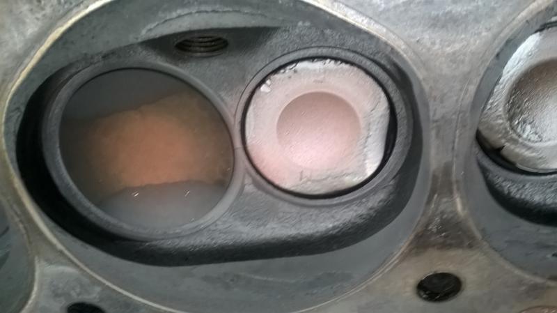

I had a running problem with my 3.0 omc 1989. I took the head off and i noticed that all the exhaust valves are burned. So much that the are bend . Which resulted in a crack in the cilinderhead. Now is my question what the cause could be. I ordered a new head. not that i burn the new valves. I live in Europe maybe we use a different type of unleaded fuel? 95 octane we have overhere.
