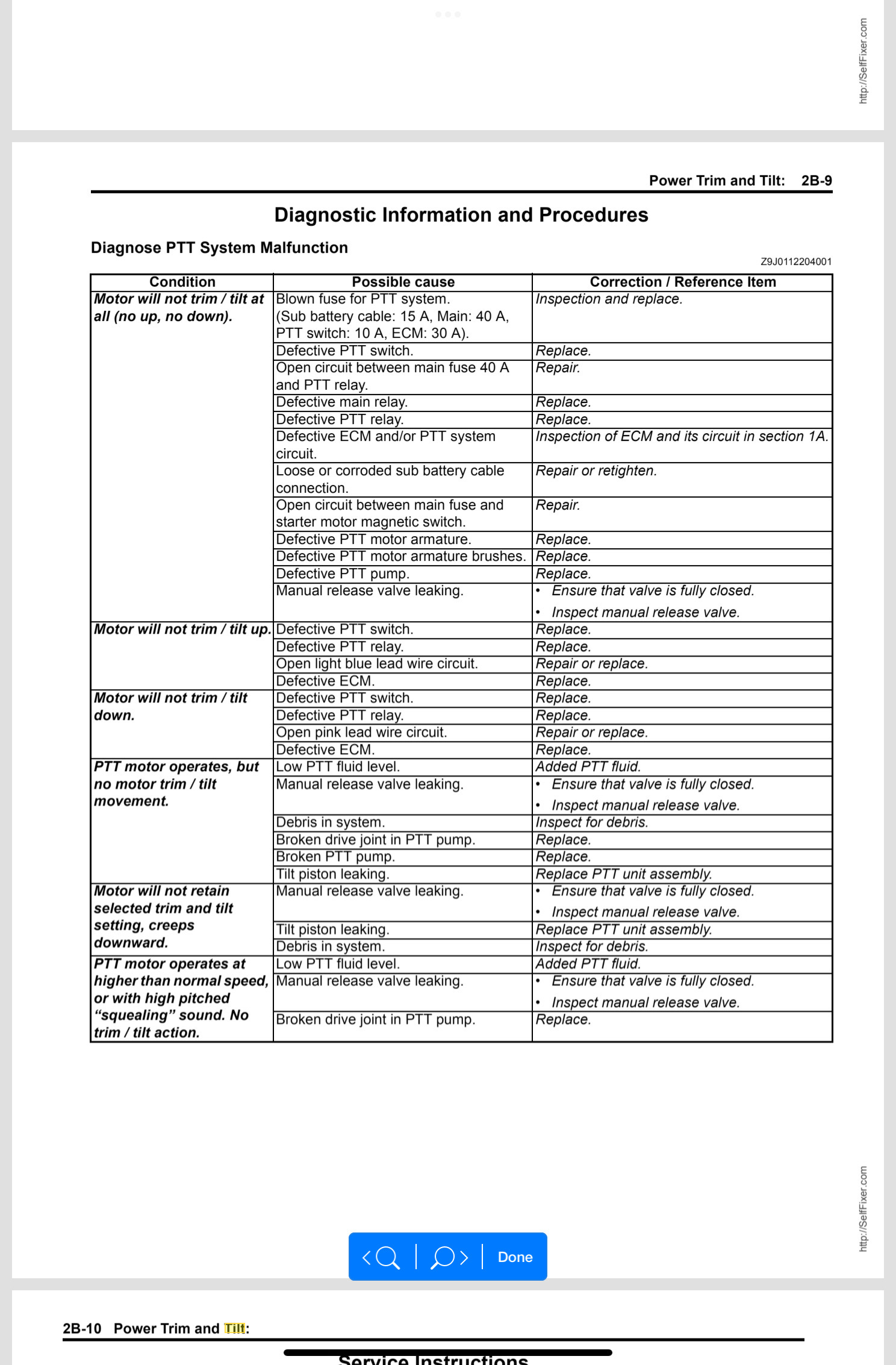

Your engine won’t start or your trim/tilt motor doesn’t respond to you depressing the tilt/trim switch on the binnacle but the trim/tilt switch on the engine works?
Some reading material.
Or see below. The below screenshot is from a 2009 DF90A
