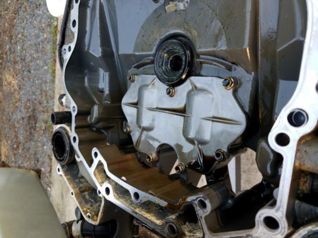

I bought the boat and motor used last December. I did the SB #56 already. Last week I had an oil leak down the starboard side of the engine.

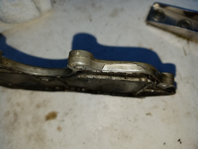

Today i pulled the power head and found that the cover actually had a piece missing from the side.
It turns out it was coming from the mount rubber cover.
While taking apart the oil pan, I found a piece of metal. Bingo, it was a perfect fit to the mount cover.
I tried to upload pics, but couldn't get it to work.
