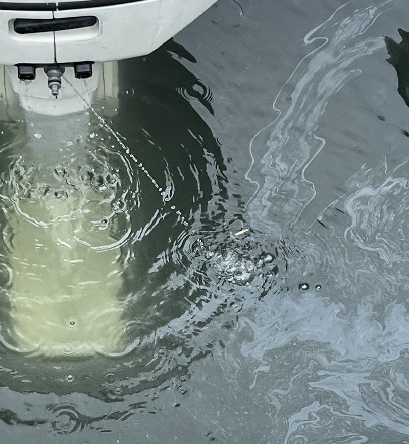

I had to pump the fuel bulb to get her started. Once started idled fine. Left the marina and had to return to the dock a few minutes later due to weather. Never exceeded 2000 rpm’s. Close to the dock the motor stalled and had to pump the fuel bulb to restart. Once docked I noticed a slick emanating from the telltale. Thoughts. My first thought was VST. Advice requested to diagnose that?
