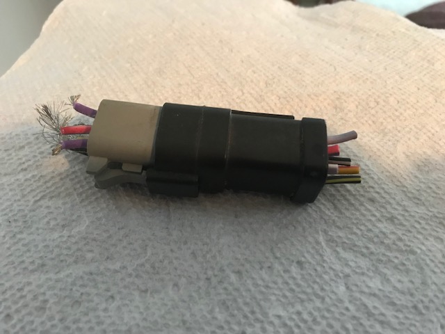

With the multimeter set on 20V I connected to the black and yellow wire and ground, I got a reading of .09 doing the math that's about 1.8V. I ran the tilt up and down twisted the motor unplugged all of the connectors and nothing changed. I disconnected the 6 lead plug just behind the control box and moving it around, I found if I elevate it vertical the voltage goes to zero and as soon as I point it towards the ground I get anything from .01 to .06. and if I plug it back in it goes back to .09. Any suggestions would be appreciated.
Where is the voltmeter attached?are thease readings key on or key off?
I removed the 6 pin plug (photo attached) that appeared to have a short and I replaced it with 6 individual connectors. Now the is zero voltage with the key off and about a halve a volt with the key on. Is that normal or do I still have issues??
