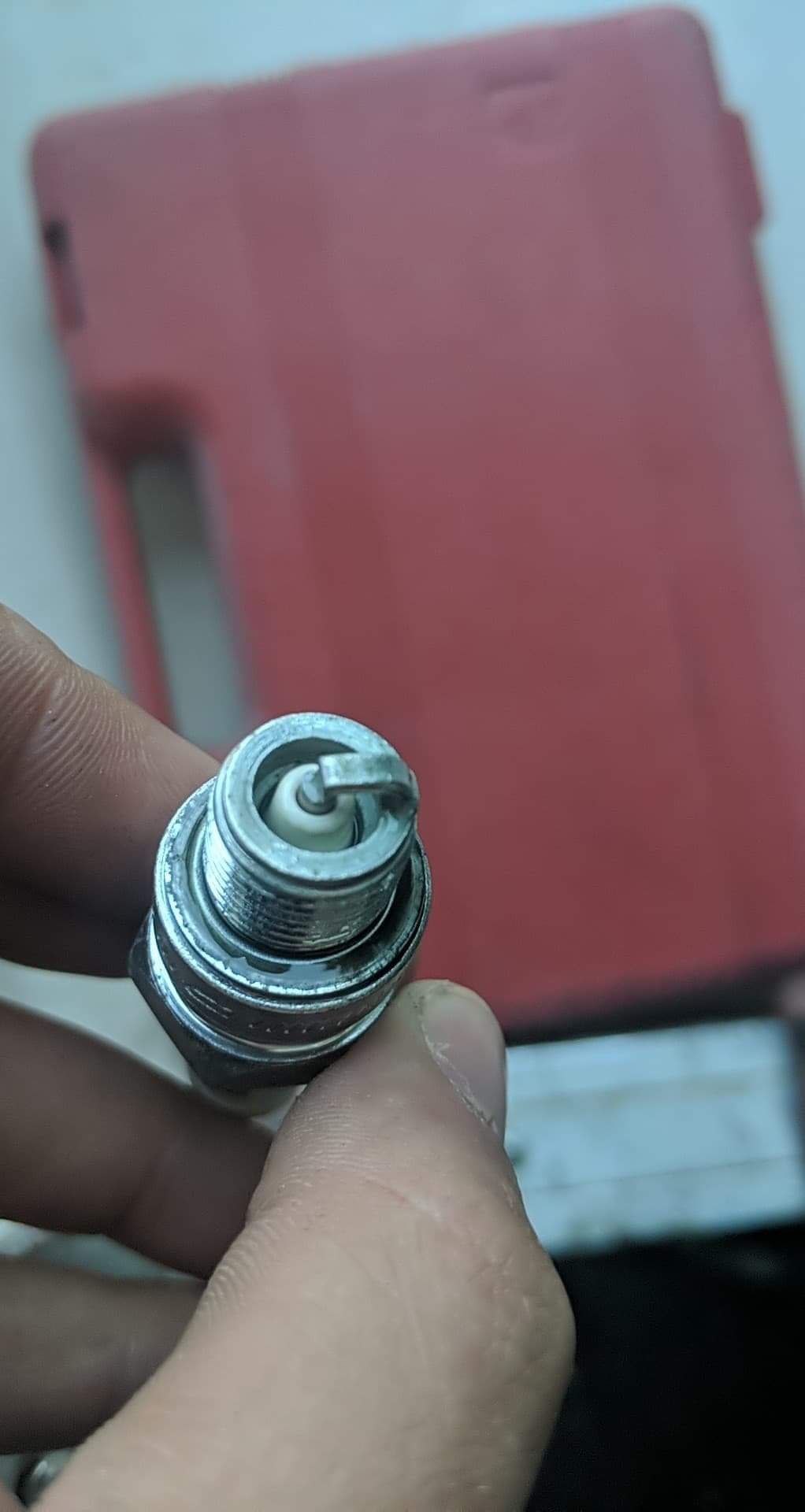

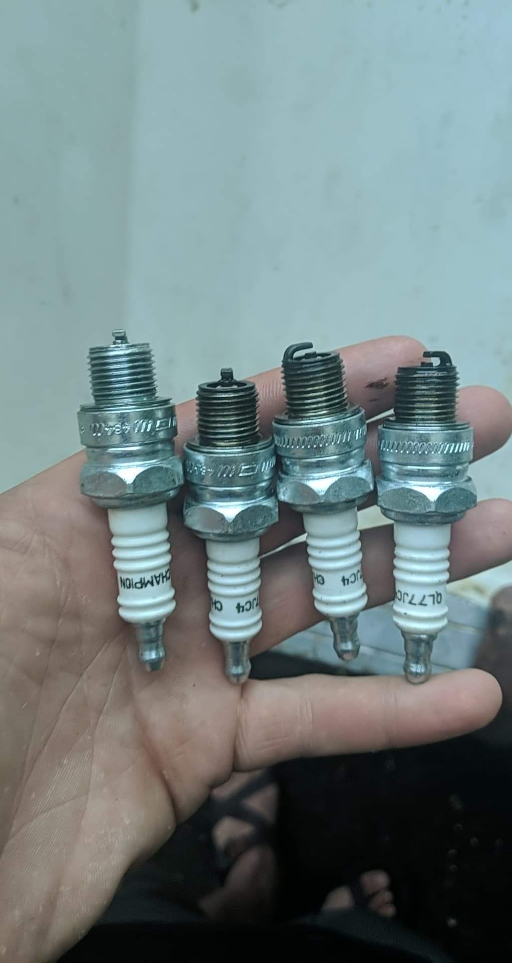

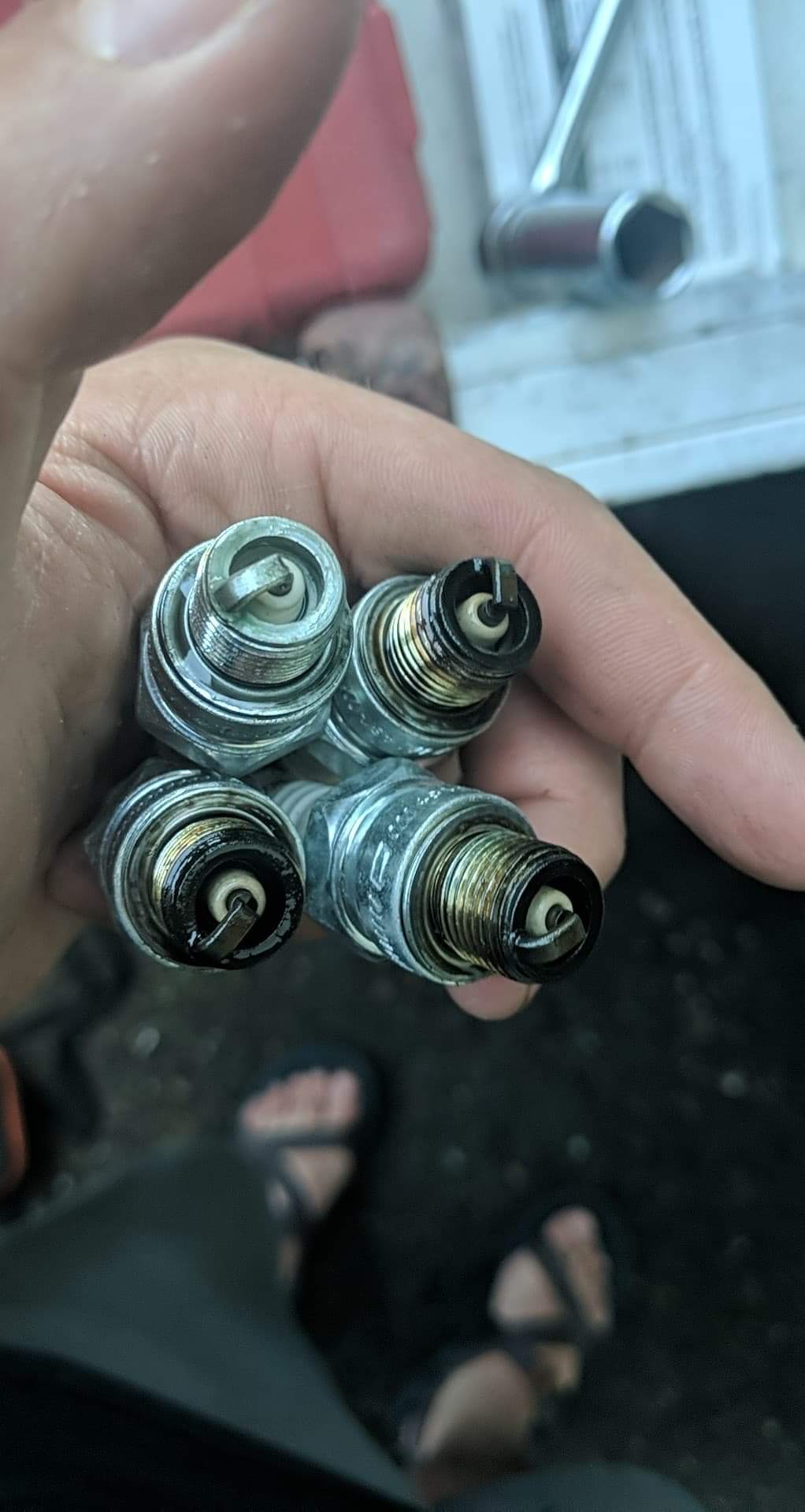

After running my engine for several hours I’m still having problems with 1 spark plug. The lower port cylinder’s spark plug is incredibly clean, even the threads. I’ve replaced the plug, coil, wire, and confirmed I have good spark. Any thoughts would be appreciated 218BBB5B-BFAB-4C2C-A461-C41018821594.jpegD2A4D3DE-A009-45A6-8D0D-4FE6958A9D07.jpegDF4DE3DE-6F73-432D-9308-38FA1309F2F3.jpeg
Reasons.----No fuel ,way too much fuel, no compression , no crankcase compression or weak spark.------Do a compression test first.----Then see if spark will jump a gap of 3/8" or more.----What fuel pump is on this motor ?
Compression test is 112psi in that cylinder. All the rest are between 112-120. Bought a spark tester and all of them jump well beyond a 3/8” gap. Doesn’t seem like over fueling is an issue nor does under fueling. Spark plug is clearly wet. It has the older non VRO style fuel pump. All other cylinders are running perfectly as can be seen in the photo. Main thought I’m coming to is potentially water getting into the cylinder... but with the compression being adequate I’m hesitant to pull the head.
Water getting into the cylinder was my first thought, but I decided to go the simpler route until proven otherwise. Is it "wet" with fuel or is it wet with water?
I can’t quite tell, it looks more like a milky gas mix. So a combo of the two. Do you know which gaskets would allow water to enter the cylinder? I’m assuming head gasket and exhaust gasket.
Milky? That's water. It can destroy the engine if not attended to.​ Likely leaks are head gasket or exhaust gaskets.
