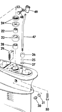

A thank you to Tim, too. I know I can get that O-ring out. My worry was how to install the new one. I am ordering it tonight. In the meantime I will rebuild the carb.
What is the nut diameter to pull the O-ring out? Can someone that has a working puller measure theirs?
The bushing has been soaking in PB-Blast for a couple of days and seems corroded in place.

It is a 5 minute job to replace that o-ring.-----If it is 45 years old you need a new one !
racerone,
You owe me a beer. 5 minute job my *****. I have been heating, PB Blasting, and slide hammering that bushing for two weeks. :D
It will come out eventually.
The good news is that the engine is coming back together. The carb, recoil starter, and tiller throttle are rebuilt and installed. :cool:
Run a 5/16-NC tap in there and pull it out with threaded rod.--------Actually the o-ring can be changed without removing the bushing.
Really....how's that? Like pulling a golf ball through a garden hose? Damn.....your a way better man than me, Racer.
Sure, almost anything is possible, but it would be fun to know the technique...... especially if it can save time and effort. They didn't teach it in schooling,....... years ago.
It finally came out! I ended up using a puller head across the top of the lower unit instead of a slide hammer. Now comes the fun part, reassembly with new seals.
Did one of those reseal jobs for a neighbor about 30 years ago.-----When I walked over to return it he said ----" done already ? "-------Motor was still on the back of the boat couple of years ago.----Did not use any special tools other than 1/4" rod with a modified nut to pull the bushing.
That's awesome.

Special tool ??----I just turn the gearcase upside down and gravity put the shifter in it's place every time.----Done it countless times with no issue !
Okay then, Racer.....please show me how to change that shift shaft o-ring.....without bushing removal. Do you slightly enlarge the lower opening and pull it through.....up into its space?
The rubber 0-ring will stretch and fit through the hole.------Nothing to it really.----I showed an OMC repair guy a trick to repair electric shift springs years ago.----He said " in my wildest dreams I would not have thought of this simple method "----Bought the tool from me on the spot.----His card said 30 + years of OMC experience.-----But others have scoffed when I suggested that it could be repaired.-----The factory manual says install new spring , therefor it can not be repaired !
