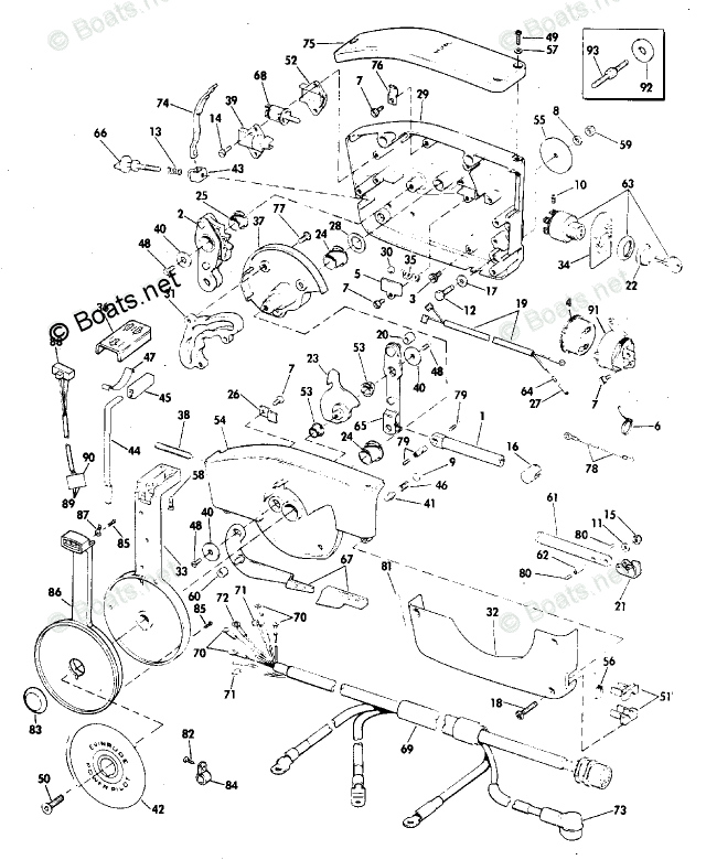

I found this schematic which is identical to how my engine and remote are set up, but i cant find the actual "engine kill switch" that is on the drawing.
