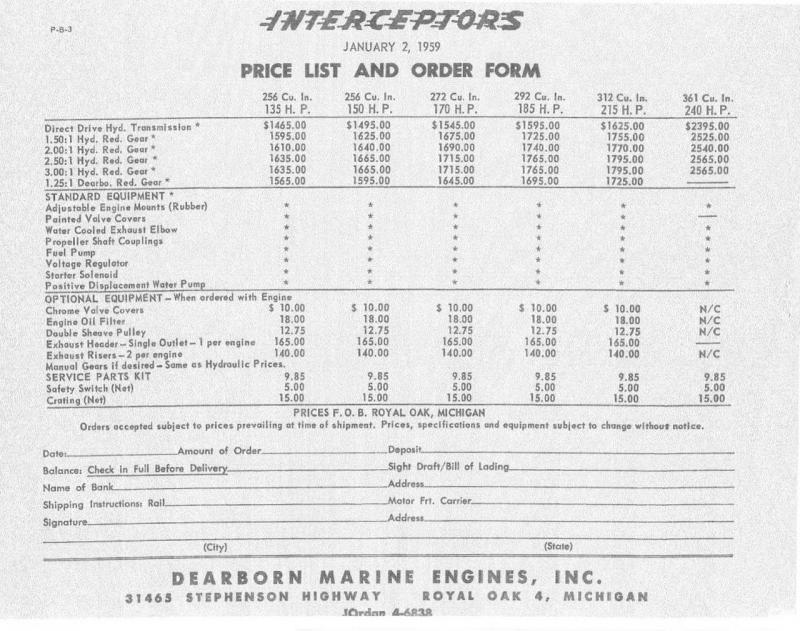

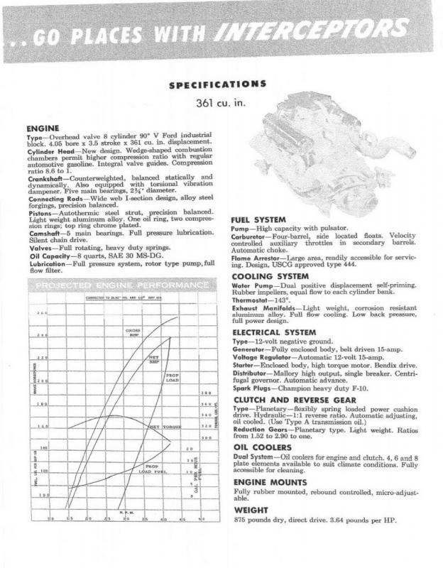

Well this is proof that the older you get the more you learn.
Here we are "how many years later???" commenting on the same old thread, but with new info !!!!!
Interceptor did, indeed, use a 361 and here is the proof.
With the introduction of the 332/352 was the 361, an FE big-block available only in the 1958-59
Edsel and 1958 Ford Police Interceptors. The 361 had the 332/352s 3.30-inch stroke. However, it
had a larger 4.05-inch cylinder bore the same as the 390 to come later in 1961
