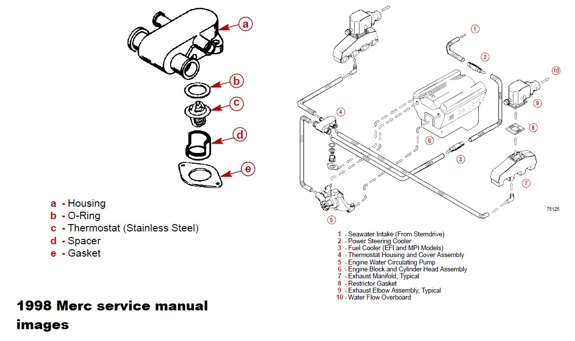

Below is the image of your thermostat housing. The parts and order in which they are installed make a difference how the water flows.
The thermostat housing top casting you have 4 connections.
One, is cold water in (oil filter side of casting)
two, are cold water out, Smaller diameter and feed exhaust manifolds. These have cold water all the time before thermostat opens.
one, large hose which connect to on engine circulation water pump.
Operation-
Engine cold, Thermostat closed, Cold water comes in thru one hose on thermostat housing, it is sent out two smaller hoses directly to exhaust. It also flows into engine thru pump.
When engine block water temps reach ~160* the thermostat opens and this 160* +/- water now mixes with the fresh cold water and gets circulated thru engine and to exhaust manifold. Because of this you have no control over the water temps going to the exhaust manifolds.
So there are only a few possibilities.
1. Low water flow from Outdrive impeller assembly (Impeller, Missing slinger, dam between water pump assembly and thru prop exhaust not present or eroded away or not installed at all or properly) This should be explored to confirm this is functioning as designed.
2. Clogged exhaust elbows- You said you replaced.
3. Clogged small hose output of thermostat housing, Do both outputs look exactly the same or is it possible one has corroded and is not allowing enough water flow?
4. Exhaust manifolds have corrosion issues, Less likely but possible.
Images of thermostat and parts layout and orientation. Also water circulation image.

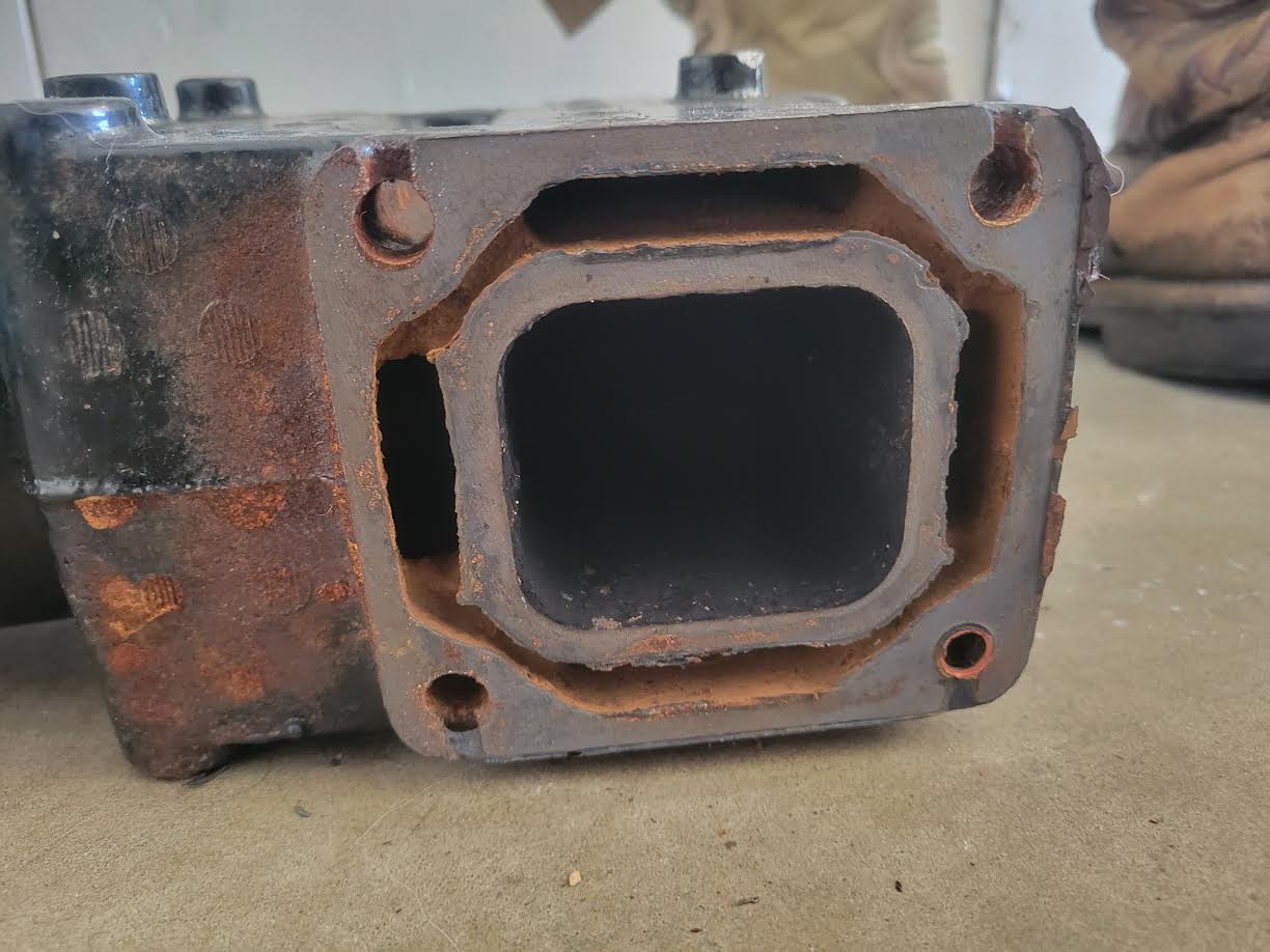

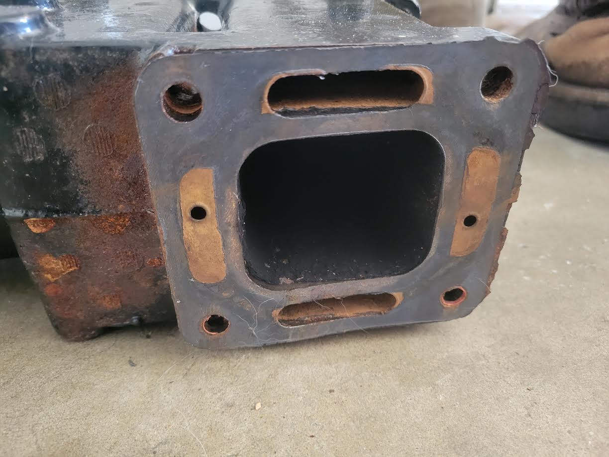

A little update on the issue. I looked at the old gasket for the riser and found that I put the wrong gasket on. There was an oval shaped spot that I thought was the gasket hole for the water to flow through, it turns out it was just the outline of the manifold and there just just a small hole in the riser gasket for the water to flow through. Looks like the website I looked on was wrong about which gasket goes on this riser. My fault for not double checking. New gaskets are on order and I will check the flappers while I have it apart. Also have a new thermostat kit on the way. I don't see how having more water flow would cause the temp difference but we will see. I'll post an update after I run it with the new gaskets and thermostat.
I'm a little confused. Mine looks like the one on the left side of the picture with small holes in the gasket, not the open ones on all 4 sides. Both types of gaskets are #5. When I look at the elbow it has open holes on all 4 sides but the gasket has 2 oval shaped holes and 2 small pin holes on the gasket. So which one would be correct? Did they have the wrong gasket on before(the one with 2 oval holes and 2 small pon holes)?
The first picture is with the old gasket on the old riser, the second picture is just the bottom of the old riser with no gasket on it. Was the gasket that was on it the wrong one? Why would the riser have 4 big oval holes and the gasket just have 2 small holes and 2 oval holes? This is where I'm getting confused.
The one on the left is the correct one.
The image on the right ( item 5 for riser kits) is for a SPACER/riser kit used when the elbow height has be higher for certain boat applications such as thru hull exhaust. The gasket used between manifold and spacer has all four holes which allows full water flow to top gasket between spacer and elbow which is the same as the gasket used for your application (manifold to elbow). If this was not the case and you used the same gaskets with small holes the spacer would get much hotter than it should.
Think of it like this, When a spacer is used and the gasket has all four open holes between the manifold and spacer, It is as the spacer is a part of the manifold. It is just extended higher.
The correct one has two large holes and two small holes. The small holes control flow so the water does not exit manifolds to fast without taking the heat with it.
If all four where wide open the manifolds would get much hotter. The small holes allows some water flow so the hot water itself doesnt build up pressure and blow out the gasket

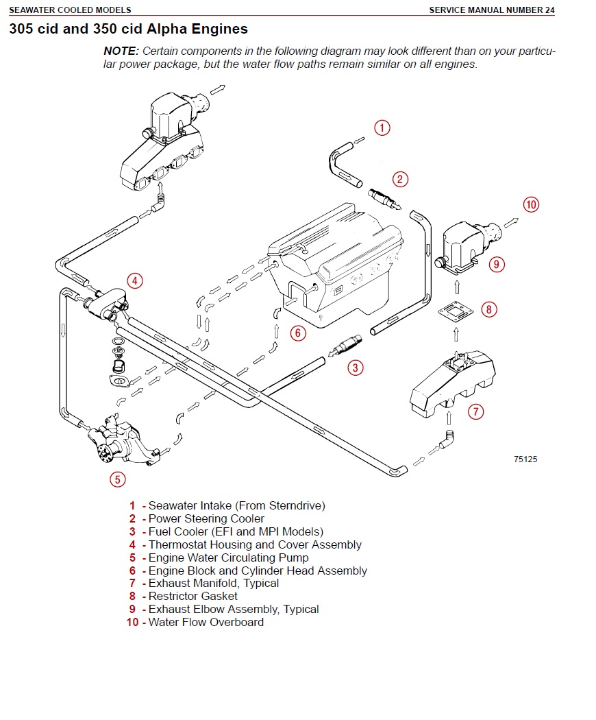

Below is a copy from Manual.
Just make sure gasket is oriented the way it shows in the image below.........open holes in gasket on the left and right and small holes front to back
