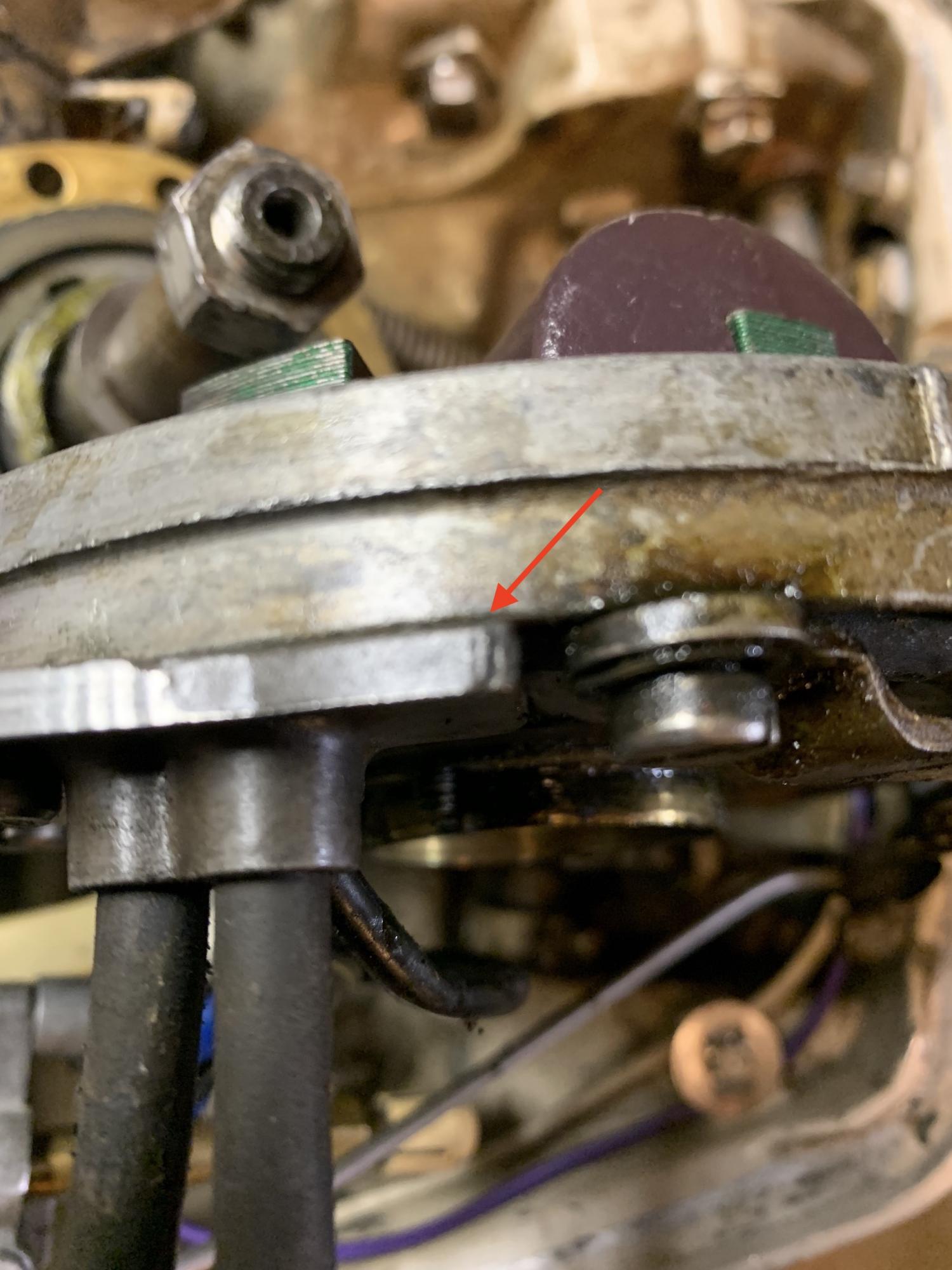

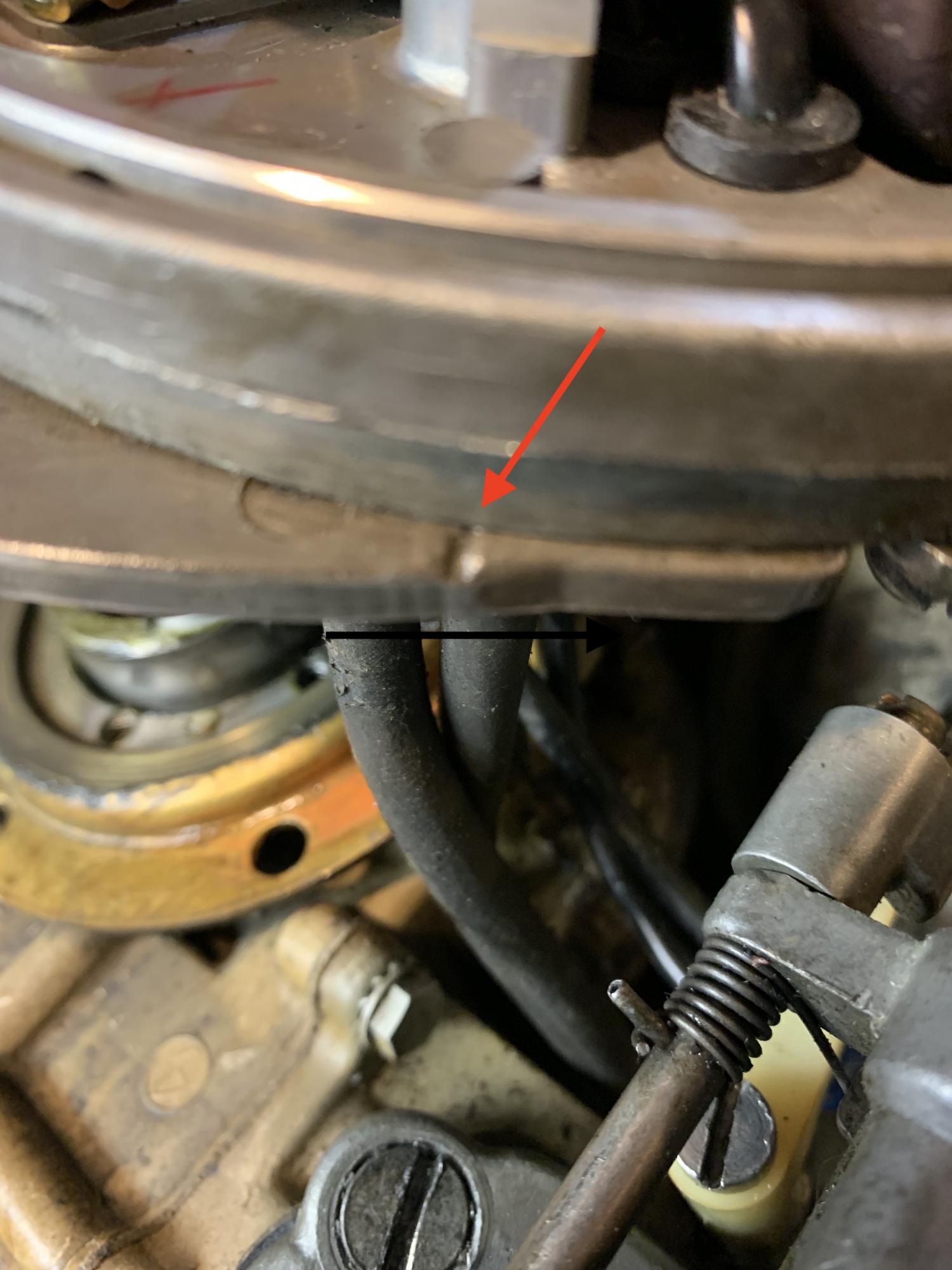

Hey Guys....thanks for all the feedback....I've got the magneto plate back off in search of "the mark", just to get that box checked first. I'm going to attempt to upload two pics I just took.....my novice eyes now see TWO "marks", about an inch apart. One looks like an indention or divot (on the top of the cam) and the other like a "1" (at the very beginning of the cam, on the face of the cam). So, now I need to know which, if either of these marks, is actually "the mark."
Here goes with the pics....may have to upload separately, I'm not sure....bare with me.
Size photos at under 1000k. Everybody loves to help with these great old 9.5's.
Note to Gator: I think Brian changed the dampers on that one, he didn't use the stock originals....but yes, it really ran sweet when it was done. That young man has some real talent.
First picture, that is the "mark" on top of the cam. I really don't know what that other one is on the toe of the cam.

Racerone....you were right on "the mark" (sorry, I couldn't resist). I've already made the adjustment (it was pretty much spot-on anyway), but will have to wait until I return (see below) for another attempt in the test tank.
