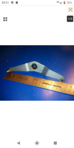

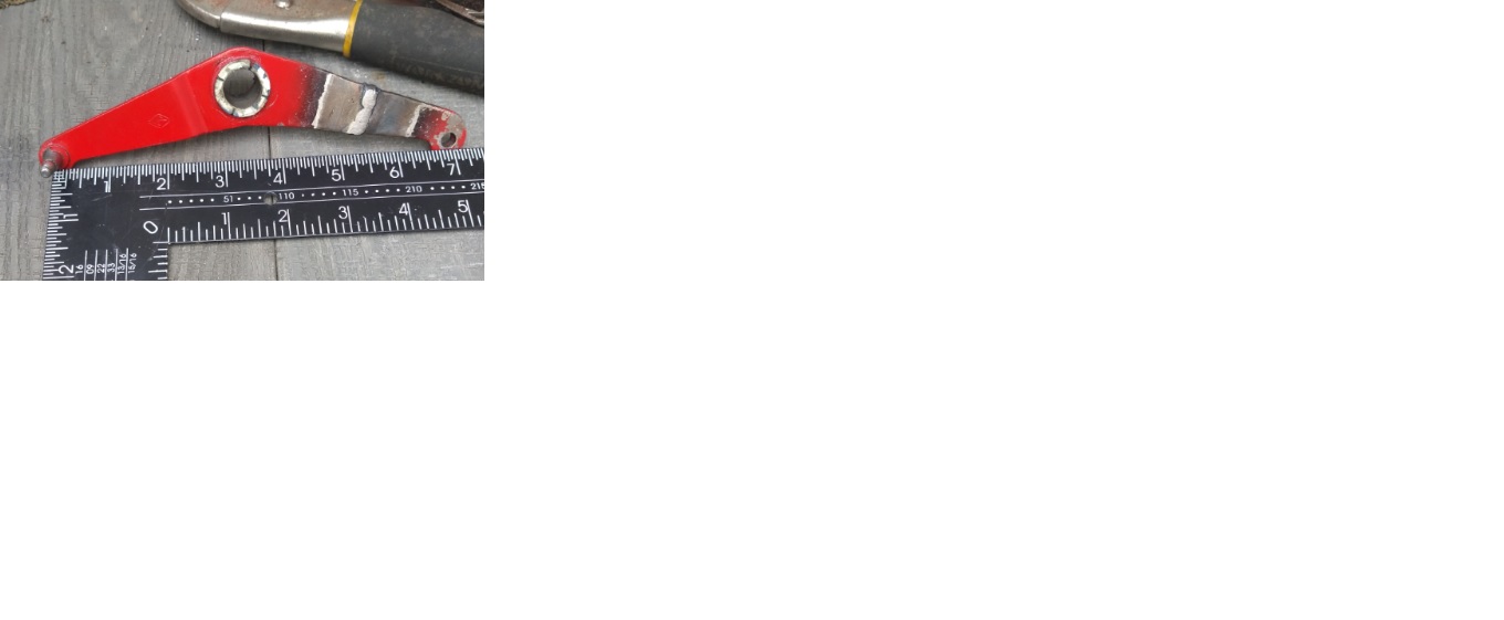

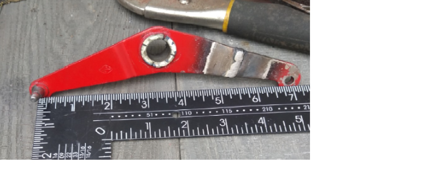

    Any pictures of the altered shift linkages ??

    Hi the red is the one that's fitted at the moment.

    The original 73 lower unit shifted to forward with a DOWN motion of the shift rod.----So how does the lower unit on there now shift to forward ?----I would not hesitate here to pull the lower unit apart for inspection.

    It is shifting opposite to what the 1973 models did.----So it has a NEWER lower unit installed today.-----Need to revisit modifications made to linkages.

    Look into shift linkages as used on 1977 - to 2000 models.

    Just an update, I extended the bell crank to 8.5" same angle and it's catching good and tight now so looks all good,
