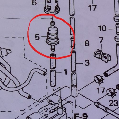

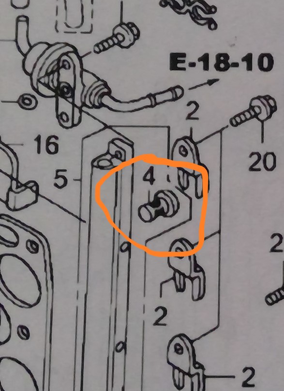

BLUF: Looking for a guide on installing the mesh fuel filter (#4) on the fuel rail and the fuel pump filter on top of the VST, behind the injector base (#5).

MESH FUEL FILTER
I removed the pressure regulator on my fuel rail couldn't get the mesh filter out. From the manual it looks like the filter fits into the fuel rain and the pressure regulator seats on top. I didn't pull the entire fuel rail off the engine so my access is limited. I don't want to damage the seating area where the pressure regulator sits. Heck I'm not even sure there is a filter in there since the last owner didn't have a LP fuel filter and the HP one was very dirty. Is there a trick that I'm missing or should I try and use a pick to remove it?
FUEL PUMP FILTER
Is there a trick to changing the filter? Since its behind the injector base I don't want to start pulling hoses if it's bolted to something.
