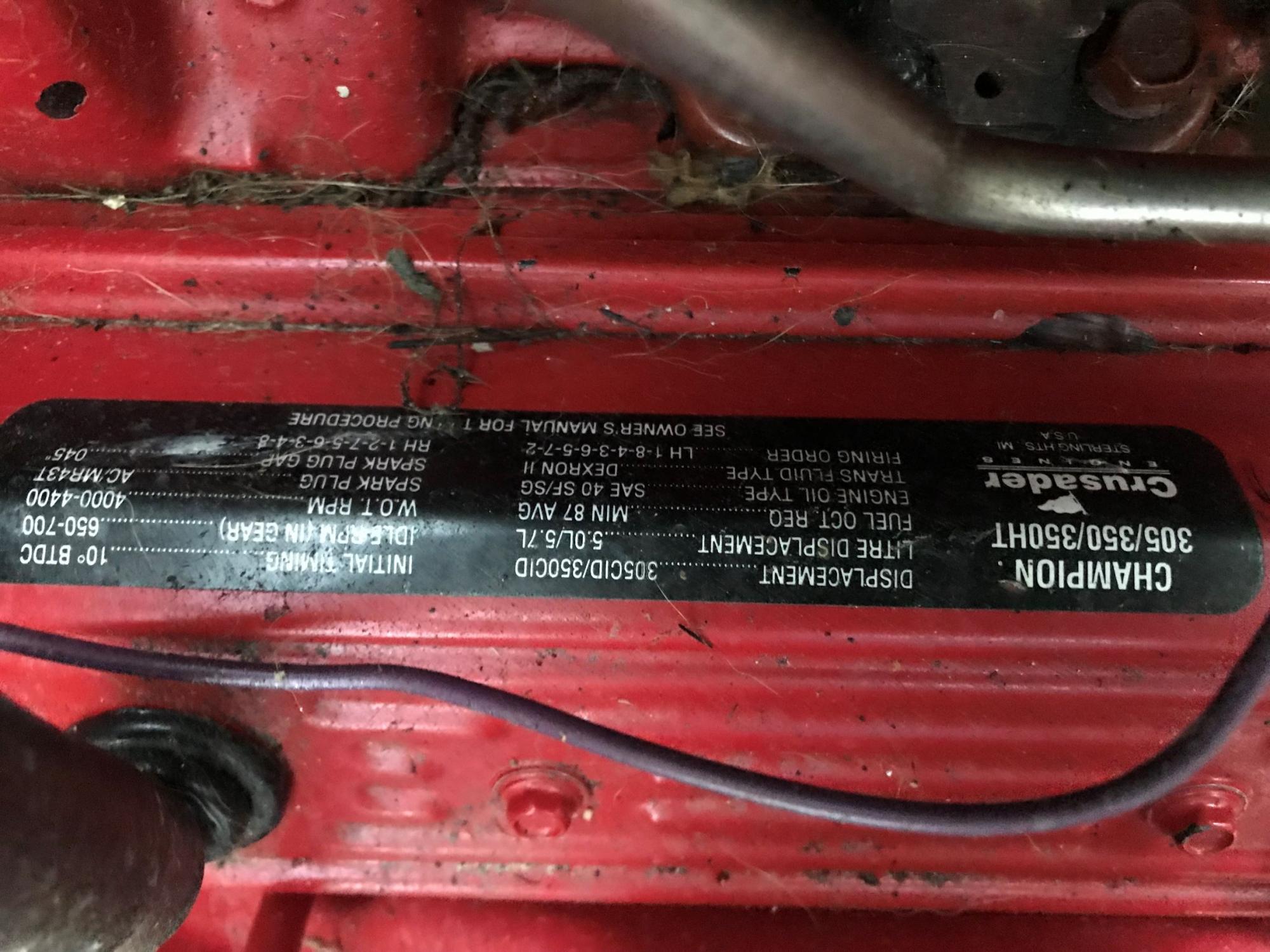

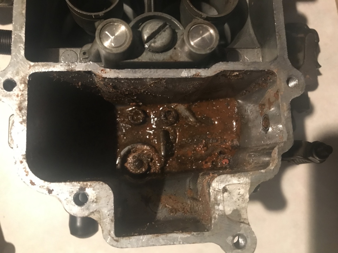

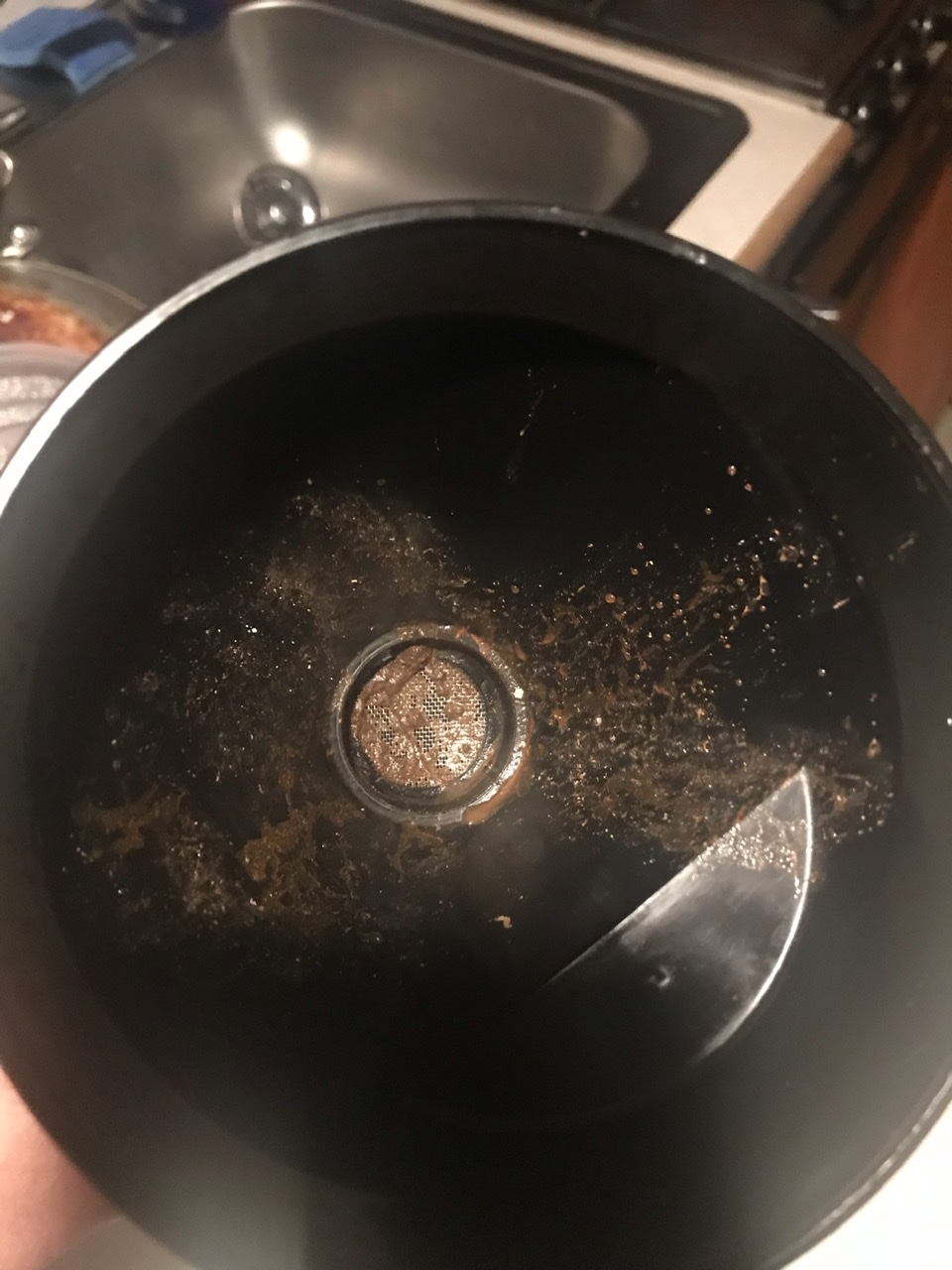

2. Pulled carb and turned it over into a funnel and collected what is in the water bottle pic below
3. Opened up carb and you can see below that the left bowl is full of something bad

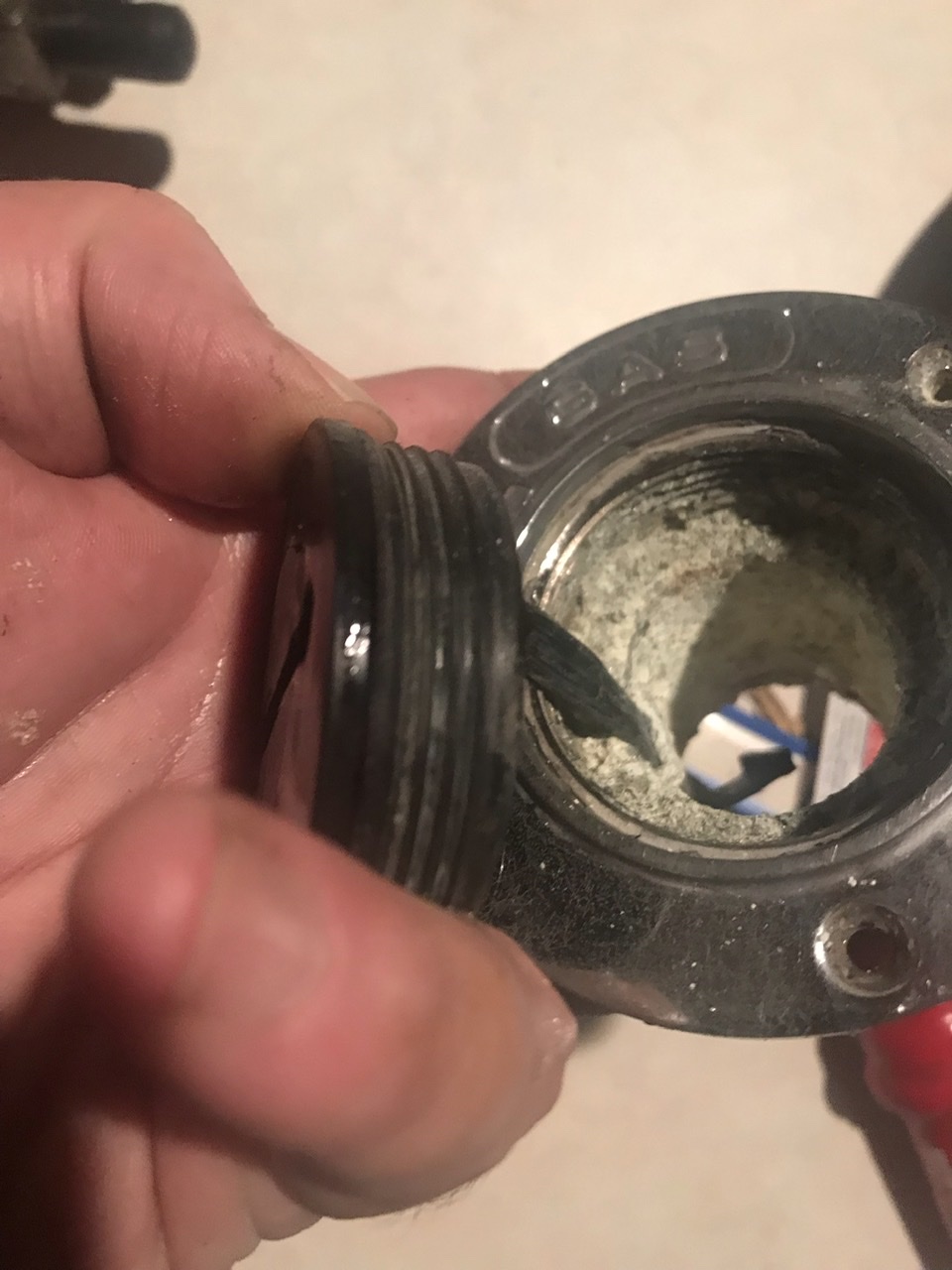

4. Removed fuel fill fitting (which is flat in the back deck and exposed to rain.
Note I have never put anything but marine gas in her. I have owned her for 9 years. Can’t speak for prior owners.
So what is everyone’s assessment? Is that dirt or water in that fuel sample? Why is it only in one bowl? What is that inside my fuel fill fitting (it’s been there since i owned boat). Do I need to pump my fuel tank out? Is it worth it to rebuild the carb? What are my next steps?
looks like both to me, the cloudiness suggest the fuel is degraded.
Cant tell due to lack of info...guess would be fuel line is plugged or the float was stuck shut.
My guess is corrosion of the pot metal due to water...looks like the threads are filled/eroded such that the cap can't compress the o-ring to make a good seal. cast stainless fittings don't do this...
