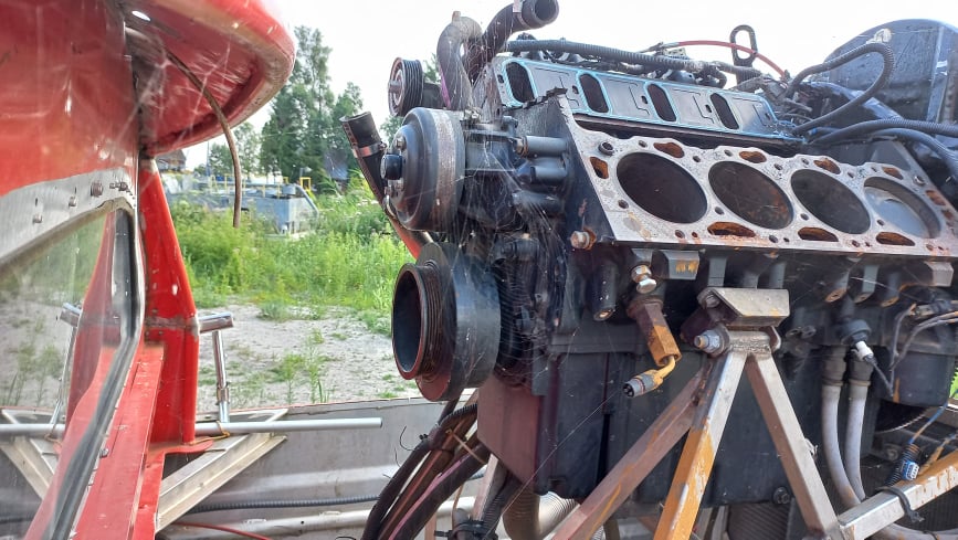

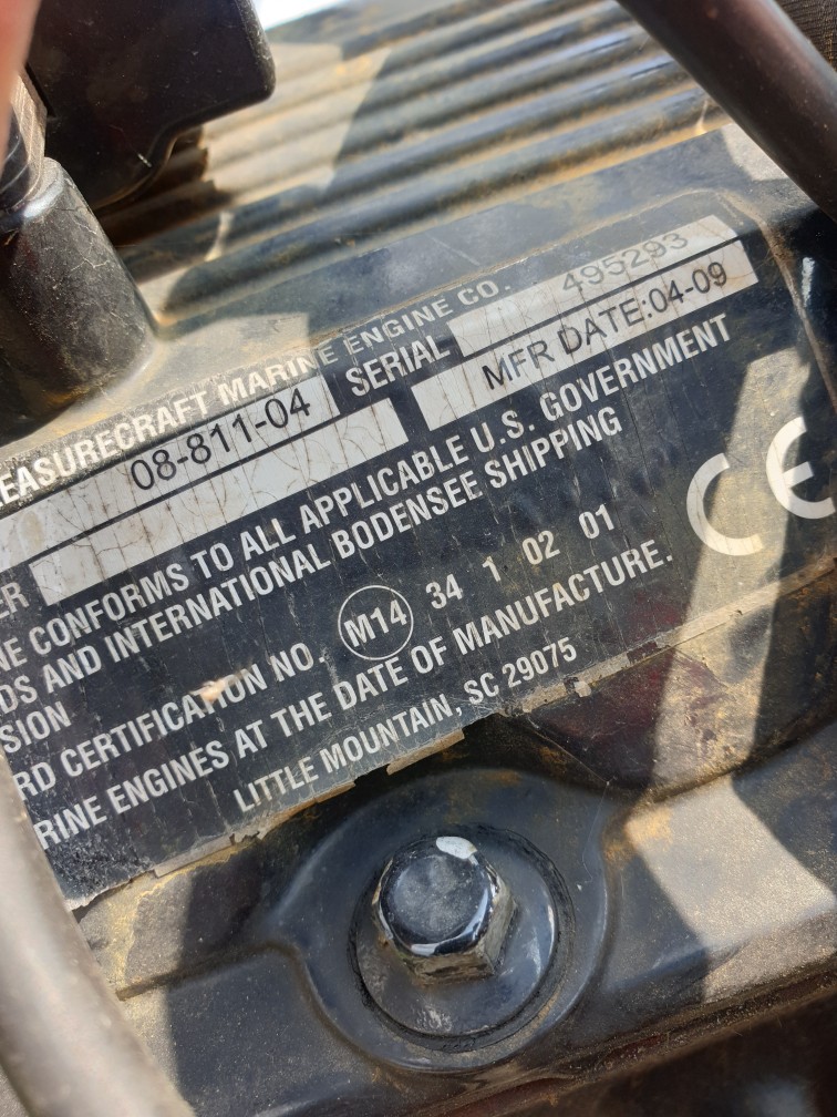

I'm looking for an engine for an Airboat. Below is a photo of the nameplate. Could you please tell me what type of engine it is?

look on the block on the side where the head has been pulled, just behind where the mount bolts to the block...if you see < 8.1L >cast into the block (vertically) than that's what you have...
