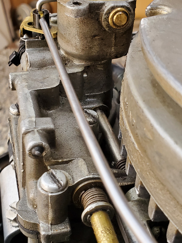

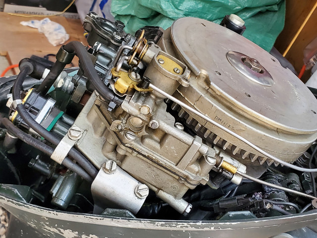

    Hey just bought this thing from a backyard mechanic
    The motor hesitates at very low idle
    But runs nice at higher rpms
    Can you spot the problems?

    Sounds like it might be running on 1 cylinder.-----Compression test needed.----Post the values.----Check spark.-----Good spark on those can easily jump a gap of 5/16" on a test device.----Other than that I see a 9.5 HP motor in the pictures.----Looks just like other 9.5 HP motors.-----Worked on lots and have a bunch of parts motors.

    Where's a video of it hesitating at slow idle? That motor has been overheated at some time in it's life. May or may not have anything to do with it.

    Paint is scorched on the cylinder head and exhaust manifold.
