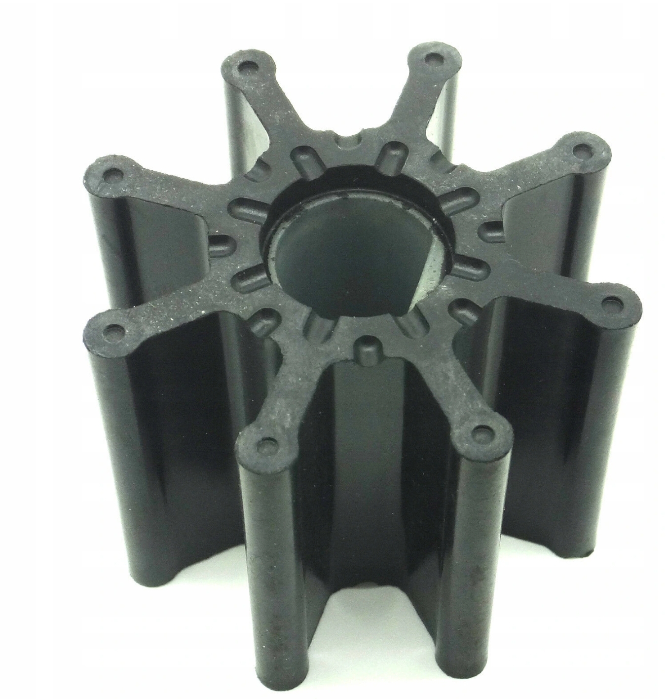

The pump implerer was replaced. After replacing there was some a problem with the pump drawing the water and the engine was overheated on the land.

In my opinion, there is a problem with water intake for cooling. Perhaps the elements are salted by the waters of the Adriatic Sea (although the yacht was sailing normally for one day, no faults). The second one may be a defective Implerer. Pipes at the zip line are clean, undamaged.
