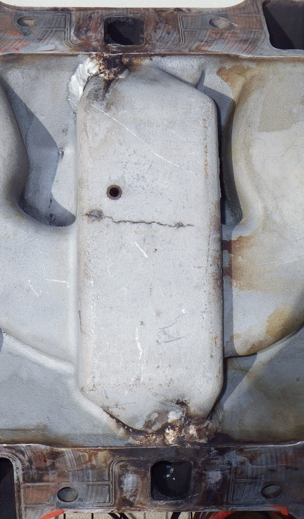

B & RB Chryslers have heat crossovers on the bottom of the intake manifold. If these are not sealed, it's possible they can expel exhaust fumes. On rare occasion they have been known to crack. This his happens more with aftermarket aluminum manifolds.
This Edelbrock CH4B RB manifold had cracks repaired and it cracked again........
