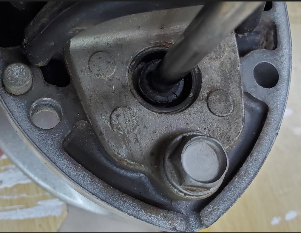

Well, when I take off the water pump, and then remove the 3 bolts on the top of the "gear box" (for lack of better term) that plate which has the seals in it, the plate will lift up about 1/4" and then it comes to a hard stop. JGMO indicates that in order to access that area, I would need to remove the propshaft holder and the accompanying parts. Getting it apart is not the part I am concerned with :)
Here is a picture of the plate that is bolted back down, and the shift shaft seal which has me a bit spooked.
Top gearbox plate with the three bolts. This is the unit which only lifts up about 1/4" :
This is the shift shaft seal which has cracks in it. I suspect that I will water test it, then if no leaks I will drop the lower unit, and put some marine grease on the top side to try and limit any additional oxidation.
Your concern regarding the cracked seal is valid. Changing that one and the others is a good plan if you are able. It'll save your daughter from some potentially expensive repairs down the road.
I don't believe there's anything that needs to be done below prior to removing that "block". the hard stop is much more likely being caused by a seal caught in a grove or something.
I'm not real sure, but believe JGMO may have confused "drive shaft" for "prop shaft". He'll pop in here soon I think to confirm. -Al

MAYBE it the shift shaft that's hanging you up? Are you able to lift up on that?
Note that the 30 in the video has a totally different design, and he was using a slide hammer, not an impact hammer. Further, he was working on a salt water motor, and judging by you're earlier pics, you are working on a fresh water motor. WAY different animals from a practical standpoint. As a snowbird, I work on Florida motors quite a bit (mostly salties) and work on all fresh water engines while in Michigan (a complete breeze as compared to the salties)....
Yup! good eye. Freshwater motor only. I can't tell if it is hanging up on the shifter or the drive shaft. But I was hoping that the pinion gear was resting on the top of the gear stack, and simply starting to raise that plate would just cause the main drive shaft and shifter to easily lift out. When I hit resistance, I panicked and set it back down.
It looks like the seal for the shift shaft presses in from the top side (from looking at that drawing of the top plate... the bottom of that plate is shaped like a "cone" for the shift shaft).
