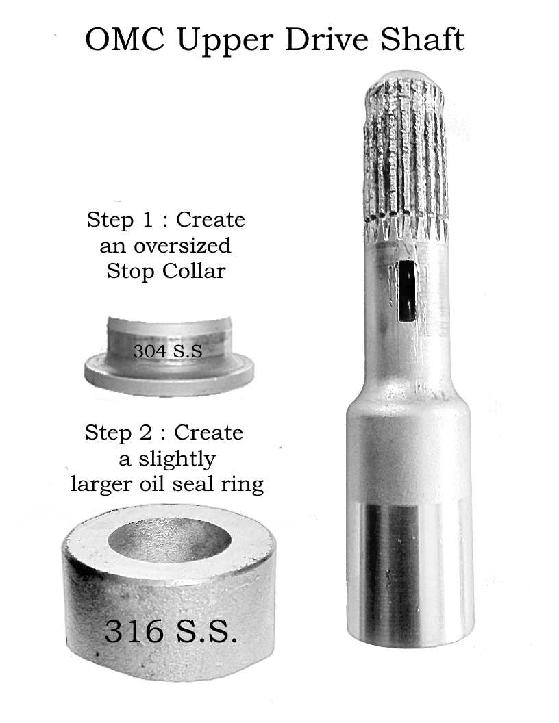

I have a 1974 OMC 120 h.p. with the usual or inherent faulty upper shaft. Every 200 hours, like clock work, they corrode and then strip out. They also destroy the upper splines of the water pump shaft, as well. (Always in pairs.) I have been working on a permanent solution for this. It involves reworking a used water pump shaft (free) with a good set of lower splines. I am doing 3 of these and it works out to about $500 each in machine work. The cost of both shafts and seals can add up to the same (not including labor). Since they could last 1000 hours or more (30 years) then they will pay for themselves.
Here is a picture and a drawing for those who are interested in doing the same. I can supply better pictures if you wish to email me.
I am doing 3 of these and at first believed how it worked out to about $500 each in machine work. I was able to reduce this cost down to $275 CND which is a very cost effective replacement. OMC also makes a stainless steel water pump housing. Together these two improvements can NOW make these outdrives maintenance free for 10 years or more. With lower horsepower engines such as the 140 or 120 GM engines, I consider them very dependable and almost bullet proof.

M-22411-High-Profile.jpgPlan B Step 1.jpgYes, I believe his should/could work for a high-profile upper unit provided you started with an equivalent high-profile water pump shaft. (An 8-inch P/N 22411 High Profile OMC #908087). However, the ones I fabricated have been, done (in stages) by 3 different machine shops. My dilemma was, Vancouver, B.C. area has few machine shops and I couldn’t find anyone that could replicate the 20 internal spline sets. If you reside in the USA then you should be able to locate a shop and have a couple replicated from scratch. (Do you have a spare stern drive? Outside of EBAY; these parts can be, found cheap.)
I believe a 404 stainless is salt water resistant. Just beware some types such as 17-4PH can be heat treated but then they are not resistant to salt water which defeats the purpose.
Like you, I’ve had mine for decades and have gone through 3 shafts now. Therefore, if you can get a few made for $500- $600 each then they should pay for themselves since they should save you from also replacing the WP shafts, seals, and always inclusive labor. (Also, you need to replace those (5) top cap bolts (¼ x 2 with a ¼ x 2 1/4 bolts) and also install Heli coils inserts. I had mine strip out and the entire lower half of the drive (65 lbs.) was dangling by the shift wires.)
Lastly, if you noticed ANY wear on your pump shaft then your upper shaft is just about gone. Replace them in PAIRS (always) or else you will ruin your new WP shaft in about 10 to 15 hours or so.
Are you aware that OMC has a stainless-steel replacement for the original 12390-pump housing (aluminum)? They last indefinitely and even after 10 years the impellor shows little wear. With these three modifications then these OMC stringers are great and dependable drives.

I agree that grease helps but it wears away eventually, especially in salt water. I submerged an old shaft in fresh water and 2 weeks later it was beginning to rust. When these upper splines rust out they also take out the impeller shaft. The repair bill usually runs around $2,000 and up. By reworking an old impeller shaft I now have a rust free upper shaft that should last 30 years or more in any environment. Fix it right once and you never have to worry about it. Just check your oil levels every month or so.
