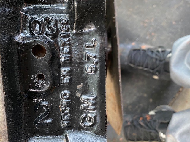

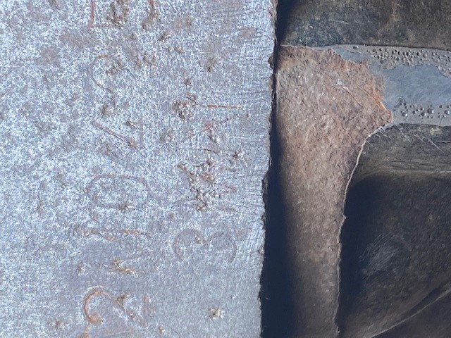

    Hello im new to this forum. Need help with finding out what motor i have. I got a boat for free and need some help.
    I know the block say's 5.7l engine block number 10243880. I found numbers on engine EC021154, and 2m04253mn.
    Thank you

    Here is a pic

Name:	Engine brand.jpg
ID:	25354Click image for larger version.
ID:	25355Click image for larger version.
Name:	Sn number.jpg

    Default Re: Help verify engine please
    If it has not been bored first over, that would be a GM SBC 5.7L engine fitted with the dreaded GM Full Dished pistons!
    It is also set up with a roller cam follower camshaft.
    With the long body coolant circulating pump, it's most likely an Automotive SBC.
    What are your plans for it?
    Are you thinking about using it in a Marine application?

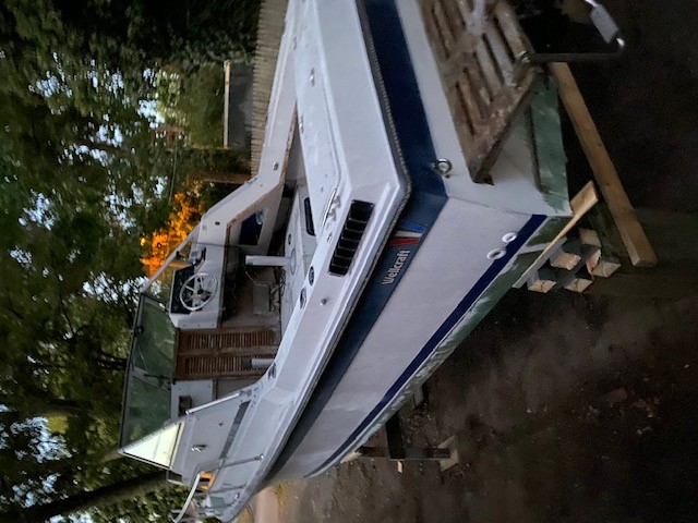

ID:	25358I was told it came out of Master craft ski boat. 1998-02. Has indmar intake, Brass freeze plugs. Going in this boat.
    We typically do not see the long body engine coolant circulating pump being used in a Marine application.
    This is what leads me to think that the engine is an automotive SBC.
    If so, it will not be correct for your use without some internal changes.
    Here are a few SBCs used by Mastercraft in/around 1998.
    As you can see, they are using the short body Engine Coolant Circulating Pump.
    (one pic deleted.... too large)

    Yes, the Marine version SBC engine is based on the Automotive engine.
    The engine does have brass freeze plugs.
    Those are casting core plugs... aka welch plugs.
    "Freeze plug" is a misnomer and is a carry-over from years and years ago.
    Anything else i can show on the engine to help?
    Not without pulling the camshaft to get the p/n.
    Also has marine heads, per the part number i looked up.
    Again, the Marine version SBC engine is based on the Automotive engine..... so casting numbers may be the same.

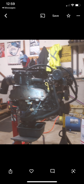

Name:	Full engine pic.png
ID:	25364 here is a full engine pic of it.
    Yes, the 5.7L is a SBC.
    Do you plan to over haul it? If so, I can offer some suggestions.

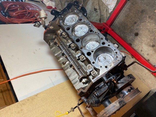

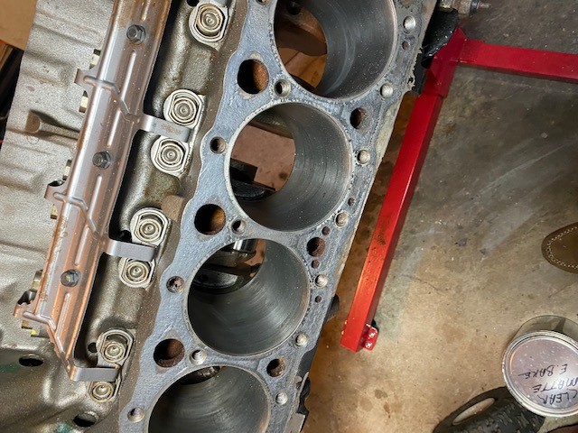

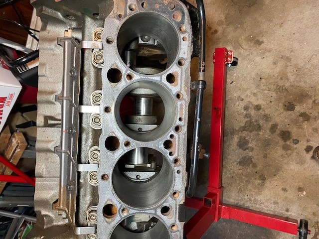

  20. #20
ID:	25366I have the motor teared down. Gonna hone the cylinders to clean them up.
    Quote Originally Posted by Mark
    I'd just measure the cam to see what it is...
    I agree with Mark.... use a dial indicator and degree wheel, and lean the camshaft specs. The over-lap needs to be suitable for Marine use.
    unless you are tearing the engine down to rebuild it...
    Looks as though he's doing a re-furbish, not a true tear-down and rebuild!
    Are you planning to leave the crankshaft and camshaft installed while you do this work?
    If so, make sure to cover the connecting rod journals prior honing the cylinders.
    https://www.youtube.com/watch?v=f7JuMGsyDAg
    Are you planning to re-use the GM Full Dished pistons?
    If so, check the fit, and make sure that the piston dish volume is correct for the cylinder head combustion chamber volume.
    This will determine the Static C/R. It must be suitable for Marine use.
    If not, I would suggest using a LCQ style piston that is suitable for your cylinder head combustion chamber volume.
    Since your cross-hatching will be rather light, you may want to consider going back together with cast iron rings.
    If this will be raw water cooled, you will want to use the Marine head gaskets.
    If it will be closed system cooled, a high grade automotive gasket set will work.
    Once the heads are back on, I would suggest using the 8 stop static cam follower adjustment procedure.... not the 2 or 3 stop.
    Make dang certain that your ignition system is correct for Marine use!
    The automotive system would not only violate USCG regs, the advance curve would be incorrect and could cause damage!
    Good luck!
