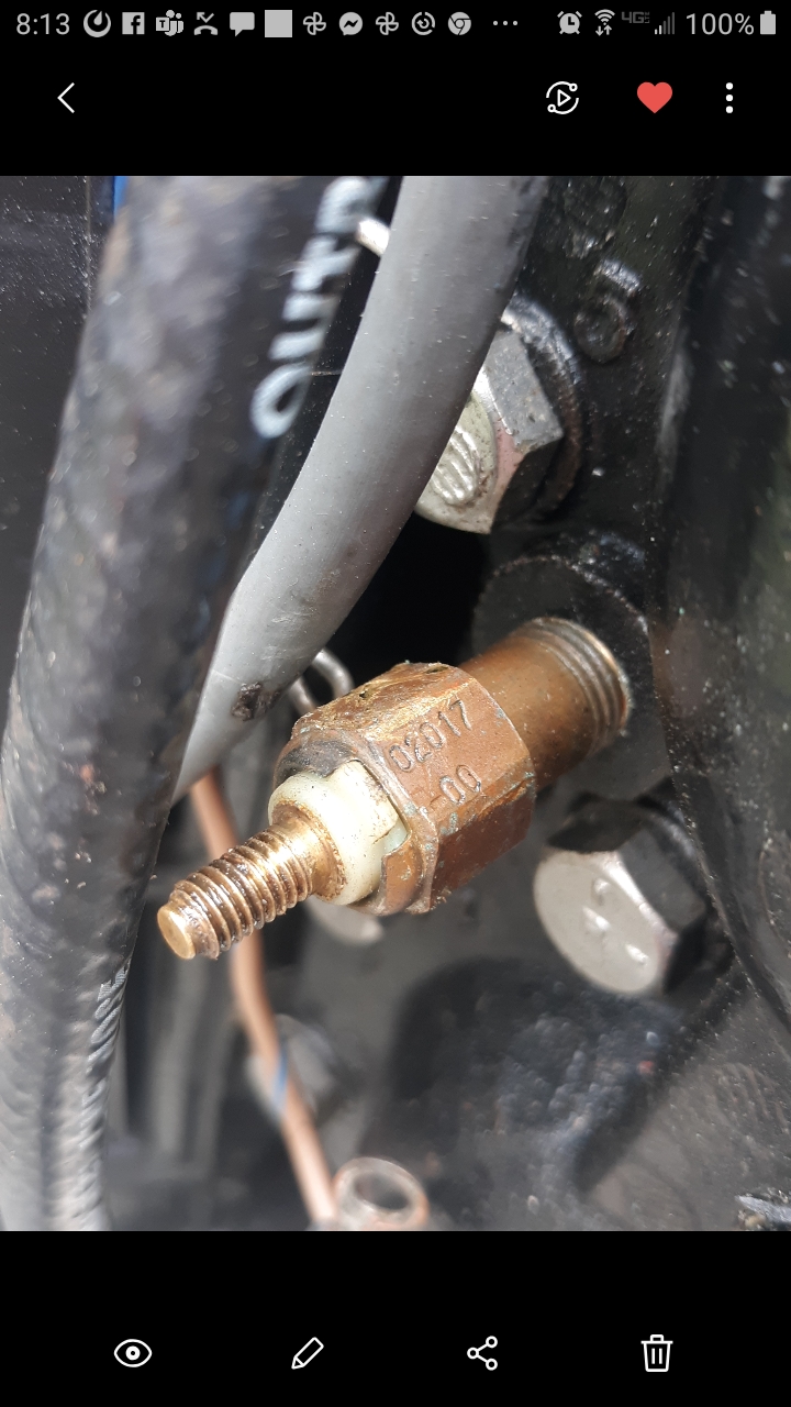

Been having problem with the temperature at high speed. At idle it is at 160, but at full throttle it goes to 220. Changed the impeller and bought new thermostats and still the same. Running without thermostats it sits at 160 ish. I checked the resistance on the sensor and it had 700 ohms at 65 degrees and 60 ohms at 212. Not sure if this is correct or not. It looks to be the original guage on the four winns boat. Does anyone know if this is correct part? I couldn't find one in the parts list for my J90ELECM model
