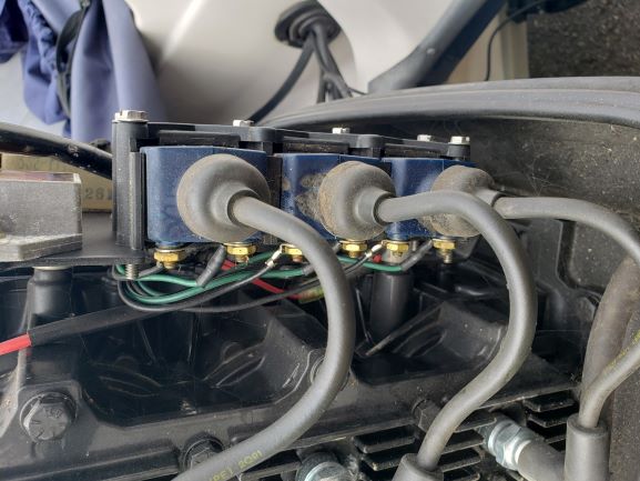

Might help with the year, model??
Just replace the boot.
After 5 posts you can add pictures.
Show us the problem?

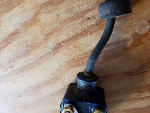

The pics show a newer model coil.
That's why the year/model is so important.
The older coils, the wire's integral to the
coil and needs to be replaced complete except
the plug boot.
The new wire can be taken completely apart
and be bought separate if needed.
821945A28 5-20$ depending on where you
buy???
