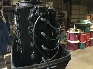

This is addition to my previous post. After looking deeper into this, it looks like the head itself is different from the 94 to the 95. As far as I can see mine is a 95 and should be torqued to 120 ft. lbs. plus a 1/4 turn. Attached is a pic of the head. I would appreciate someone verifying that.145C1DD4-2F0A-4654-85BD-80209EF47AE3.jpeg

225 in. pounds
or 18ft.pounds
IF??? you crank them to 120# your gonna risk stripping out the
soft aluminum threads in the block.
