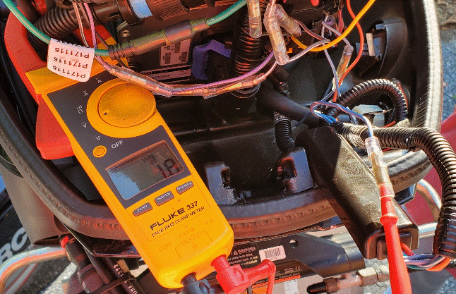

Pickup voltage on a 12v relay runs around 8-9 volts. 1.7 won't get it. If you don't have a crimp connector kit, HF and other places have terminal kits where you can just cut the bad connection off, strip the wires, and press on the new one...some kits have the crimping tool as part of the kit. Obviously size the terminal to the wire. Red/pink is probably what you'll need for the control wiring connections, but blue will work too, just crimp good and tight. Note the crimping tool is color coded on the crimper part of the tool. Some tools use the same size crimp for blue and red. Glad this is moving along.

The 1.8V is coming from the Trim Limit Kit Module, Blue White wire feeding the relay (see picture) - when the up trim button is depressed the unit supplies only 1.8VDC.
