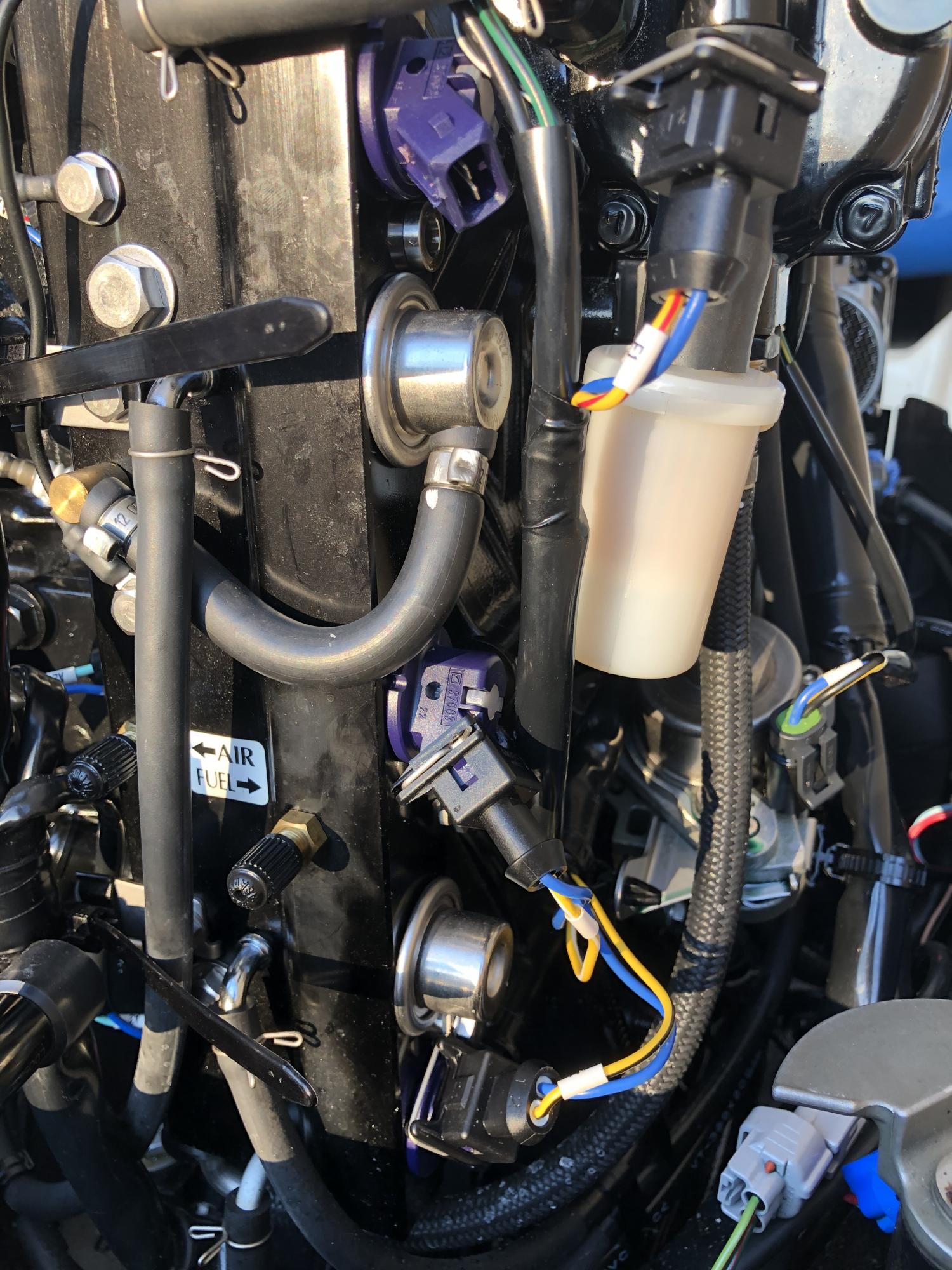

    Ok, Paul (and/or anyone ) I'm not sure which one is the #1 fuel injector (are they numbered top down or bottom up?) so I measured all 3.
    On all three fuel injectors, I got 1.5 ohms (sometimes 1.6 or 1.7 when I wiggled, but mostly 1.5). The service manual says "1.7-1.9 ohms at 68F." Well it was 83-85 when I measured. So not sure if that means 1.5 is ok or not. Do you?
    But the connectors don't all look the same. See picture here: https://ibb.co/nrfL1t4
    The #2 ingnition coil (assuming it's the one in the middle) read .6 between the first two posts (manual says .4-.6) and 14 kohms between the third post and the end of the plug cord (manual says 10.8-16.2 khoms). So those all check out just fine.
    The CPS measured 531 at 83-85F and the manual says 425-637 at 68F.
    What do you think?

    Well, I disconnected all wiring connectors, cleaned thoroughly, and checked grounds, reconnected, and the errors return.
    Not sure what I should do next. The injectors' resistance check reads 1.5 ohms. Service manual says the range is 1.7-1.9. But then again, all 3 injectors read the 1.5 and I'm only getting an error code about #1.
    Ignition coil resistance check is within the service manual specs. So, supposedly ok, but still get the error code about the #2 ingition coil after a run.
    CPS resistance check is also within the range in the service manual, but still get the error code about it intermittently (not every run).
    Looking for advice on what to do next:
    Replace #1 fuel injector? Even though it reads 1.5 the same as the others?
    Replace all 3 fuel injectors, even though I only get a code about #1, because all three are 1.5 and the range is supposed to be 1.7-1.9?
    Replace the injector coil?
    Replace the CPS sensor?
    Any other ideas?

    To pop out the #1 fuel injector (on top in the pic) for replacement, I have removed the little metal plate and connector. Service manual says to twist it a bit to break the O-ring seal, then use flat-head screwdrivers to pop it out. I'll try that. Some questions:
    1. Any tricks to that?
    2. I assume the alignment is important? Should I mark the orientation before I pop it out? How close does it need to be?
    3. I noticed that the #1 and #2 fuel injectors have the connector cable pointing down to the left, whereas the #3 (bottom in the picture) has the connector pointing up to the left instead. Is that normal? I guess I kinda thought they'd all be lined up the same.

    As long as the fit the wiring harness, you are OK.

    Replaced all three spark plugs. The old ones didn't look great, not awful, but a bit scorched/dirty.
    Replaced the #2 injector coil.
    Replaced the #1 fuel injector. The old one did have a bunch of corrosion around the tip (see pic below).
    When replacing the #1 fuel injector, when I pulled the old one out, the injector, plus the "fuel injector adapter" (#13 in the service manual snippet below), and the "compression seal" (#12 in the service manual snippet, looks like a black o-ring), all came out with it. But the "fuel injector insert" (#11 in the manual snippet) stayed inside the Air Rail.
    Using a small screwdriver as a guide and another to push, I was able to get the compression seal back on the fuel injector insert while still way deep in the air rail. Then I replaced the fuel injector putting the fuel injector adapter in along with it. Seemed to go in fine.
    Started up the engine on the muffs, ran great. No flashing lights. But after stopping the engine, I decided to check for codes, even though the lights weren't flashing while it was running. And it gave the code for #1 fuel injector again (but not for ignition coil). Questions:
    1. I had thought if it was going to give codes, it would first flash the three lights while the engine was running, to prompt you to go look for codes. Is it normal to give a code when you do the self-diagnostics even if all 3 didn't flash while it was running?

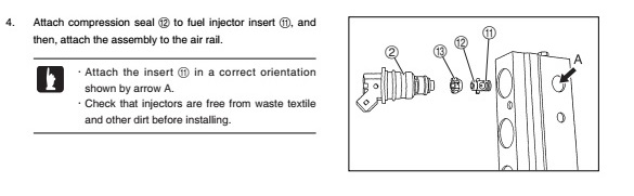

    2. Was the injector replacement normal? Was the "fuel injector insert" (#11 in diagram) supposed to come out too?
    3. What should I try next? Is it possible I didn't get the fuel injector in right?
    Service manual with part #'s:
