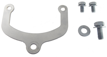

I am now trying to figure out how to keep the things from turning. There will be no steering cable attached. Is there a friction screw somewhere? I wound u tying the old 9.8's u with some ss wire to hold them in place!
[h=5]STEERING LOCK KIT - MFS9.9/15/20E[/h]
Description
Steering Lock Kit for the MFS9.9/15/20E models.Kit allows motor to be locked into a fixed position to allow boat to be steered using the boat's rudder. Perfect for sailboaters that want to use their rudder to steer instead of the motor. Kit includes installation instructions.Caution: Once installed, the motor is locked in place and cannot be used to steer the boat unless kit is removed.​
Fits MFS9.9E, MFS15E and MFS20E models only. Fits both tiller and remote models.
Part #: 3RS625000M
List Price (MSRP): $58.00
There is also (a different) one for the 9.8...

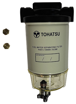

I like the water separators that Tohatsu sells. Available with a clear bowl that you can drain if water gets in there.
[h=5]WATER/FUEL SEPARATOR FILTER KIT W/ AQUAVUE BOWL[/h]
DescriptionWater/fuel separator filter with Aquavue bowl installs between your fuel tank and engine and is designed to trap 98.8% of any water that may be present in the fuel.
Unlike traditional water/fuel separators, this separator features a transparent "Aquavue" bowl to quickly see how much water has been trapped. Also features a drain screw allowing the user to drain any accumulated water without having to remove the filter.
Approved and recommended for use with ethanol blended fuels. Kit includes one 10 micron filter and connectors. Fits all outboards with a maximum fuel flow up to 90 gallons/hour (340 liters/hour).
Part #: 9999879321M
List Price (MSRP): $81.97
