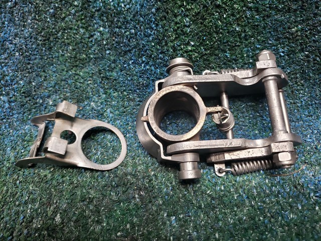

.... and how do you get grease into the "bearing" #32 on the Volvo Drive shop manual that holds the reverse latch mechanism ( curiously, this part is shown and referenced for the 290 drive and not the 280, so the #32 is the reference for a 290 drive)?
I lubed the fitting on the bottom of the yoke and the yoke moves freely with just minor finger tip pressure ( drive on a work stand), HOWEVER, the "bearing" that retains the reverse latch is quite stiff to move.
That would be the reverse latch "bearing sleeve".
The pre-290 units have anti-rotation pins...........
........ whereas the 290 does not in lieu of the metal unit that prevents rotation.
None-the-less, no grease is used within the bearing sleeve. Clean and dry does it!
The "fix" is to remove the pivot tube and the reverse latch unit (transmission and lower unit removed)!
Clean the surfaces, and re-install.
The pivot tube is rather soft.
The upper end must be in pristine condition for the beaded gasket.
This means that extreme care must be used when pushing it out of the Intermediate housing.
This is also a great time to replace the upper pivot tube bushing.

"Same" ??? The bearings are replacement spicers and about 7 seasons old....likely less than 300 hrs on them. Visually in mint condition. Feel smooth, so I'll just "exercise" them a couple of times thru their full range of motion and call it good.
BTW... thanks for the pix. Much better than the shop manual line drawing ( I have the top one)... makes reassembly of the latch easier. It's "amusing" doing it while the "bearing" is still on the drive I must admit.
